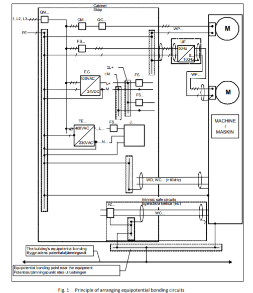

This is a picture of what we use and require when buying equipment.
It is our version on standard EN 60204-1 but this is for potential bounding to avoid EMC.
Best Regards A
Albert Einstein
