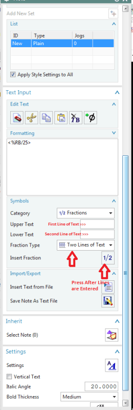

I am using NX11 and trying to link an expression in a Note. The Expression has 2 lines of text, but when the expression test displays in the note, it shows as one line. Is there a symbol that can automatically cause it to wrap or break (i.e. like using <br> in HTML code)?
 https://files.engineering.com/getfile.aspx?folder=3edda938-254c-466b-9ff0-d885a486675f&file=Capture.PNG
Yes, there was a long time ago, and it still may work, I need to look and find it
Jerry J.
UGV5-NX11
To create the two lines try using the fraction option, but use the option without the dividing line.
