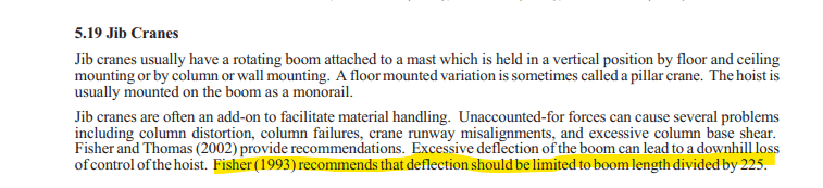

I've worked on several jib crane structures and although the Canadian design guide for cranes (Crane Supporting Steel Structures) recommends a deflection limit of L/225, I've reverse engineered several "manufactured" jib cranes and I've landed on L/150 as a deflection limit for unpowered trolleys (even though some of the manufactured units are closer to L/100). The risk is a runaway trolley if it's unpowered. I'm now working on a structure that's similar but used to land a heavy compressor in a potash mill plant. I'm design-reviewing on behalf of the operator, and deflection of this structure is more in the range of L/50 to L/70. Although there's ways we can mitigate the deflection (i.e. pre-camber), I think it will look a bit like a bent banana immediately following landing of the compressor.
So, I'm familiar with Annex D from S16 which applies strictly to beam supported at each end (L/180 is the most relaxed displacement limit). I'm also familiar with the CISC's crane-supporting steel structures design guide (see above). I'd like to give this cantilevered structure a thumbs-up, but I'm hoping to be able to reference relevant deflection limits for cantilevered structures from a Canadian design standard. I'd settle for an international design standard.

However, completely ignoring all the above, I just realized that we've somehow missed the recommendation in the crane supporting structures standard, which you could actually hang your hat on. Screenshot's from the 2004 version (first edition), so you should review the latest one. I would be fine designing to this.
