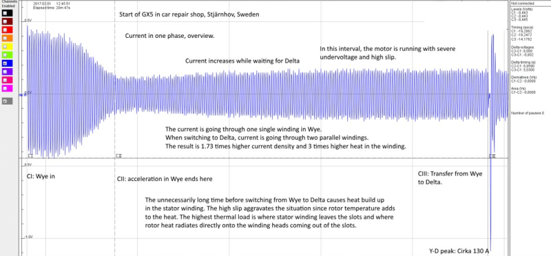

We try to avoid Y/D - it does no good in most cases and creates Heavy peak current when switching from Wye to Delta. See lower right corner of this motor current recording.
Gunnar Englund
