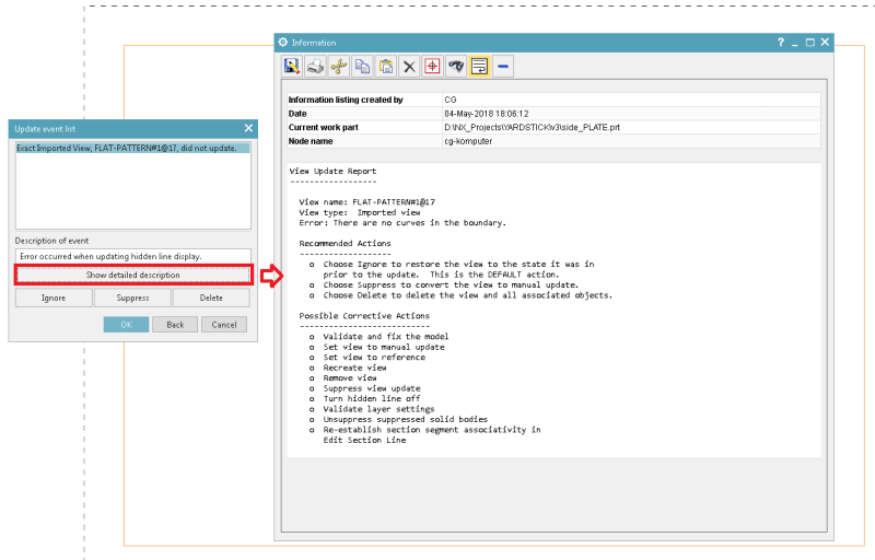

Hello there,
having problem with creating sheet metal pattern view in a draft.
When trying to do that, I'm getting this message:
Would appreciate any advice on that problem.
Try switching to that view in the 3D part. Check if there are the needed curves in there.
Are you using the correct reference set? (set it to entire part for checking)
