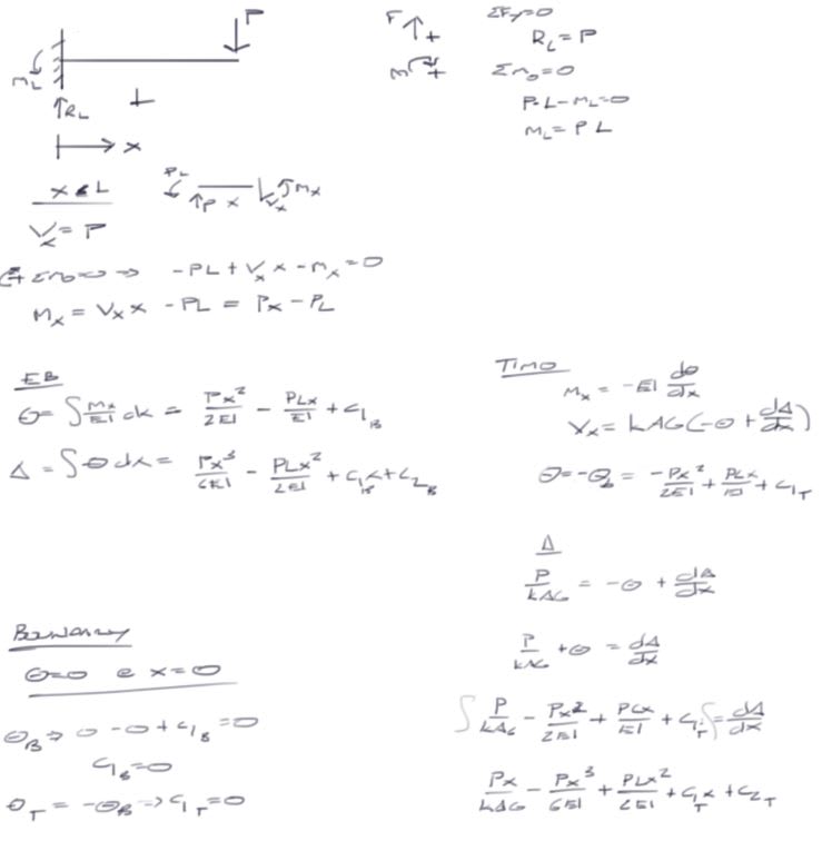

Hi!
I am writing a code in Matlab for cantilever beam with point load at the end and linear shape functions.
I can change beam's height and number of elements.
The thing I dont understand is:
Why reduced integration merged with timoshenko for deflection but merged with euler bernoulli for rotation? Both deflection and rotation are affected from shear deformation.
 https://files.engineering.com/getfile.aspx?folder=5ddf60b8-0a3c-4049-834a-03d6cdca7827&file=Screenshot_2021-06-23-18-00-24-811_com.mathworks.matlabmobile.jpg
Wikipedia-Timoshenko Beam

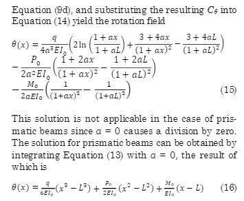

For a prismatic beam because The boundary condition is a rotation of 0 @ x=0 the coupling of the Timoshenko formulas has no impact.
(the sign change for theta in the below comes because I use a different sign convention than the wiki formula is based on)

I'd really have to dig into my notes but I think if you have a vertical shearing force the cross section rotations are consistent between Timoshenko and EB beams.
