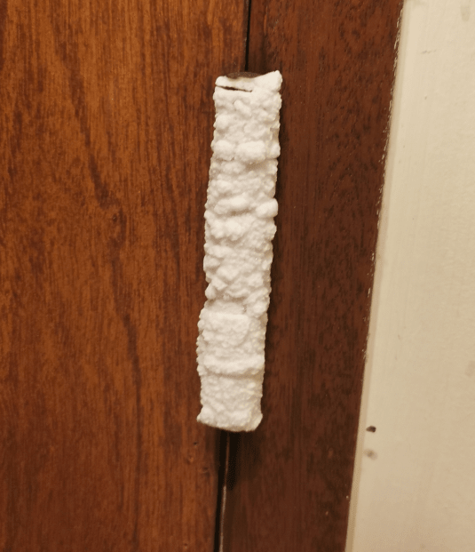

Outside front door needs repair... will do it shortly... effects shown on inside door at -37C
