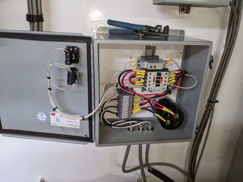

I have a circuit with a 270000uF electrolytic capacitor that gets charged direct online by a pair of 8D batteries at 24V. Is this something that I should consider some type of charging regulator for? I installed this system and found the supplying Cutler-Hammer 15 amp type BAB circuit breaker failed immediately afterwards. I don't know if the circuit breaker was previously faulty or if the inrush damaged it. This is a battery selection system which uses a voltage sensing relay to switch to a backup supply during a fault and the capacitor is to provide power during the changeover.
A pre-charge circuit consisting of a resistor in parallel with a switchable contact is probably needed while charging to limit the current. When beginning to charge, the contact is open and current is limited by the series resistor. When the capacitor is at around 95% voltage, the contactor closes and shorts around the resistor for normal operation. Search "capacitor pre-charge."

Typically for a capacitor bank that size there would be some circuitry to limit the in-rush and discharge currents.
Otherwise the currents can get very high.
The batteries provide nearly unlimited current availability.
The capacitor when discharged presents as a dead short.
You have the classical "when and immovable object is being hit by an unstoppable force" situation.
The solution is just a resistor and a parallel diode with the diode pointing back at the batteries.
This limits the "unlimited current availability" on the way into the cap but doesn't limit the current availability back out of the capacitor.
For a 15A breaker it's simply 24V / 15A = 1.6Ω of resistance or more.
For both the resistor and the diode you do need some power capacity.
The peak power that drops exponentially thru the resistor starts at 15A2 x 1.6Ω = 360W ouch!
If you can take a few seconds to precharge then a 10Ω resistor changes this to:
24V / 10 = 2.4A
2.4A2 x 10 = 57W
100W 10 Ohm
For a diode you don't say what the draw out of the cap might be so here's a hefty unit I'd use.
It's a bridge rectifier which you don't need but it's simple as hell to use, easy to mount, isolated unlike stud diodes, and spade-luggable.
Rectifier Diode 50 A 1000 V
Hook either or both "~AC" terminals to the capacitor side and then use only the "+" side back towards the batteries.

I dissected the failed circuit breaker and the weld that attaches the conductor to the bi-metallic strip had broken. The closing spring became the conductor, got hot, and annealed itself which prevented the breaker from closing.
I have not had an issue with tripping, the circuit breaker failure just raised concern about inrush. I saw no signs of burned contacts or overeating of the conductors, only the spring. I think this breaker had failed earlier.
I have experienced that the inrush is high enough to cause a power transfer with battery voltage at 26.0V and the transfer set to occur at 24.0V. Wiring is mostly 10 gauge, about 40 feet of it. In service I will likely set the transfer to occur at 21V but I haven't tested to see if there is still issue.
These breakers are not DC rated and I understand the difficulties of breaking DC but there shouldn't be serious arcing when making low voltage DC even against a dead short?
Otherwise, the system is working and I want to expand it to cover the rest of my fleet but without introducing new problems. I will provide a diagram tomorrow.
Closing into a capacitor often welds the contacts closed instantly. Remember the contacts ALWAYS bounce. The first bounce welds them.

The Cutler-Hammmer BAB is supposedly a thermal-magnetic trip. I can't find much documentation on it. Should it not trip on mag if the current were actually that high? It's not tripping during close. In fact. I used DIN terminals with a disconnect tab and I manually closed that and hardly got a spark. It doesn't behave like it's spiking with that much current. If primary power is closed first the capacitor charges through a diode. If the secondary is closed first the main contactor closes to charge the capacitor.
