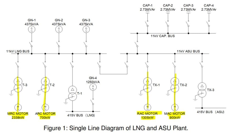

When and where is the captive transformer method of starting is preferred over VFD/Soft starter?

By captive transformer, I meant a motor with dedicated transformer, see the one line diagram picture below,

What are the project requirements? Why not a full voltage start - even less expensive and more reliable. If you are trying to reduce system voltage drop during starting, the captive transformer could be a solution, depending on the voltage drop requirements. A soft starter would probably be less expensive than a transformer and more efficient overall, assuming a bypass contactor. If the issue is reducing starting torque on the driven equipment, then that is a different analysis. Any project specification that requires all motors over a certain size to have reduced voltage starting is highly suspect to begin with.
That one-line diagram doesn't show the motor starter or any kind of protection. I doubt the operations would be happy throwing a switch closed to start those motors.
It's rather silly to put in a 1:1 transformer that size, so the transformer is likely a step-down from the 11kV bus to a lower motor voltage. This means it's not an option to use a captive transformer or a VFD, soft-starter, ATL since the motor voltage doesn't match the bus voltage. You need both, the step-down transformer and a way to actually start the motor.
I don’t see a starting method there, I just see a dedicated transformer. In that schematic, the “start” method appears to just be the switch ahead of the transformer. With no changeover scheme, this is just an Across-the-Line (DOL) starting method. Starting large motors in this way is going to be really difficult on the mechanical components in the system. I wouldn’t do it.
