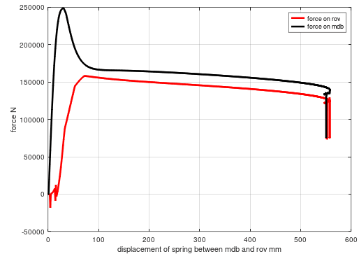

In the simple case of side impact a 1 dimensional model of a series of springs masses and dampers gives a good estimate of the force pulse into the structure
Development of a new lumped-parameter model for vehicle side-impact safety simulation
A Deb* and K C Srinivas
Centre for Product Design and Manufacturing, Indian Institute of Science, Bangalore
Here's one I did earlier
rov is rest of vehicle (ie the main body), mdb is the mobile deformable barrier. The difference between the two forces is due to the energy used to deform the structure
