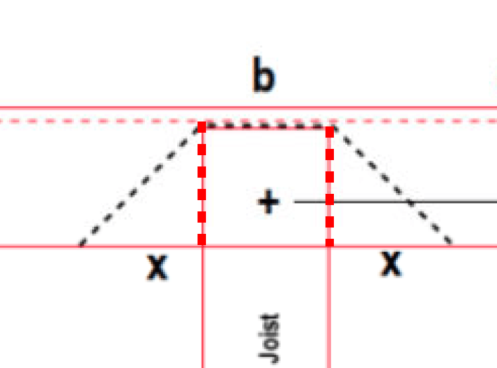

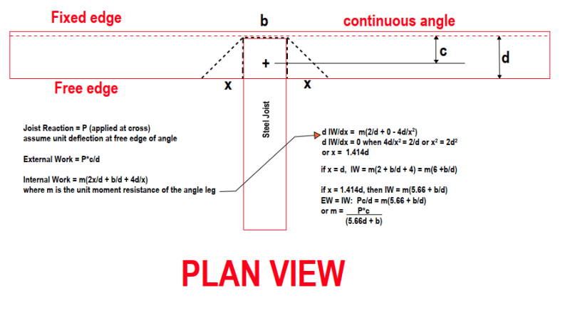

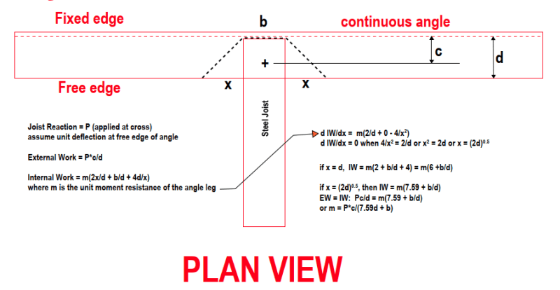

See below for yield line solution. Check carefully before using. It was done quickly.
Dik points out that I missed a couple of yield lines in the above. Below is a revised sketch which includes the missing yield lines (shown in black dashed lines). I have also corrected an error in my earlier calculations (see below).
BA
a couple of saggers...
I generally apply the load at the mid point or at the 1/3 point towards the rear... as the support deflects the point of load application moves closer to the back of the angle... (had difficulty with bak!).
Thanks dik...I should have shown those two additional yield lines which you indicate by dashed red lines. I omitted them on the drawing, but not in the analysis, so my expression for m should still be okay (unless I've made some other mistake)...which, as it turns out, I did, but have corrected it on the earlier post.
