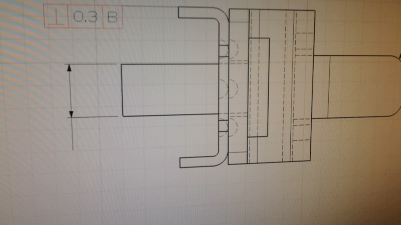

It happened today to work on a 2D file from a previous user:
The dimension shown doesn't have any value (SZ115-08013 and everything around it is just regular text), it has been suppressed be the user.
Below is how the dimension looks after I placed in "Hide" the text:
I'd like to know how he did it (I investigated the properties of the dimension, but I didn't see anything abnormal.....
Could somebody explain me how has it been done?

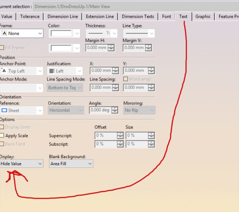

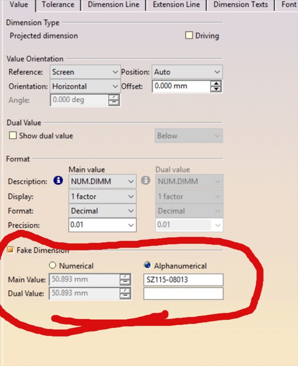

RickyT,
Thanks for your prompt reply.
The dimension was on "Hide Value", under Text/Display tab (as you shown).
