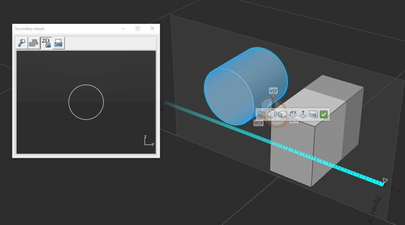

Is it possible to section just one component in an assembly of multiple components?
CAD 2015
in 2D Drafting Section Views? In properties of each instance, there is a tab for Drafting, "Do not cut in section views"
regards,
LWolf
in 3D you choose in Selection (of the definition tab in the Sectioning tool) the instances you want to cut.
regards,
LWolf

If I remember well it is possible to save the 3D section output but I don't remember exactly how.
You could combine this output from 3D section with the product that you don't want to section and you will get the result.
It might be that although you don't have the license, you could achieve with macros the missing functionality from LWolf example. You could check for it.
you have to select all the element you want to section before you call the section command
In my case I select the cylinder part first... the cube part is not selected
