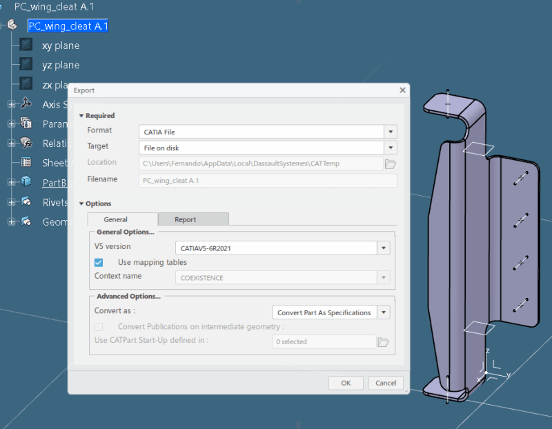

Hi, I am looking for latest downward compatibility chart with CATIA V6 R2021x and V5R31 similar to the attached.
I did contact Dassault tech support, but al they came back was this : Not know the source from where this chart is coming from (I don’t believe it came from DS), the rule of compatibility is very simple:
• As-Spec: V5-6 release matches 3DX release level … e.g. V5-6R2021 (aka V5 R31) & 3DX 6R2021x
• As-Result: V5-6 release is lower than 3DX release level … e.g. V5-6R2020 (aka V5 R30) & 3DX 6R2021x.
o These is always an option to export As-Spec to CATIA V5 level matching 3DX level.
I see and I know that they are basically a one for one but a couple years they had a range which is what I was curious about the OEM uses a bleeding edge V6 and while we can get the equal V5 it's not compatible with out TC
 https://files.engineering.com/getfile.aspx?folder=b8bb44e2-e470-4efc-91ab-78a7990b200d&file=downward_compatibility_chart_CATIA_V6_R2021x_and_V5R31.pdf
I'm using 3DX 2021x cloud. For As Result you have the option down to v5r18.
