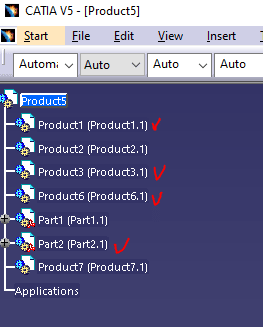

Hello. I need help with creating algorithm.
I'm trying to assign names to CATIA tree elements from table rows. See pictures:
Tree:
Table:
I have an idea how it should look roughly in pseudocode, but I don't have enough knowledge to implement it. (vb.net language or catscript\c#\vba. does not matter).

File names, instance names and partnumbers are all independent in CATIA.
Moreover, the idea of renaming specification TREE based on excel TABLE data seems like a bad one. It will lead to errors and ambigious results in models with more than one level of indentation.
Why would you want to do what you're describing in the first place? What is your final goal?

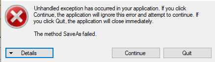

Second problem - if the root product does not exist on disk and I try to save it with a new name - I get an error 0x8004005

I don't know what i do wrong....

i'm get an error
Code:
 oSelection.Search("CATAsmSearch.Product+CATAsmSearch.Part,all")
        for i =  oSelection.Count to 0 step -1
            ' oSelection.Item(i).Value.ReferenceProduct.Parent.Save()
            oSelection.Item(i).Value.ReferenceProduct.Parent.SaveAs(pathQ & "\\" & documents1.Item(i).Name) 'HERE AN ERROR System.Runtime.InteropServices.COMException (0x80004005): Error HRESULT E_FAIL has been returned from a call to a COM component.
        Next
Inspect what value you actually use as save path and try saving using exactly that value manually. We're talking about last (first in a loop) document.
By the way loop should end with 1, not 0
