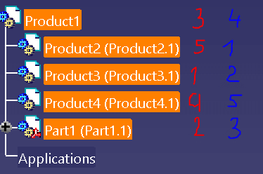

Interested in the question: in turn, I selected the necessary elements in the tree. Next, I want to change their names in the same order.
But the problem is that Сatia does not understand the order and changes names in a random order. Where is the mistake?
I did not find information in the V5Automation.chm file.
red numbers - the order of selection of elements
blue numbers - how Сatia sees their order

Selection preserves order in which elements were selected.
In fact it never behaves randomly.
how can I refer to the selected items in the order of selection?

it works like this:
5 item, 1 item, 2, 3, 4.
that is, it processes the last element of the collection first.

In a selection, the first index is the last one. And I don’t understand why.
For example 5 documents are selected. Their order: 5,1,2,3,4.

Thank you all for your help. I found a bug.
Before adding to the selection - I forgot to write the selection clear. Therefore, the selection always starts from the last found element.
