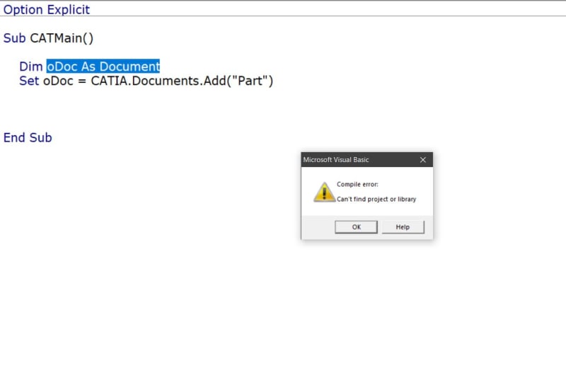

Sep 16, 2020 #1 NaWin55 Mechanical Mar 21, 2020 97 IN Hi I need help ASAP i am getting this library related error in catia vb macro i tried reinstalling catia and same error is coming, it was working fine few days back but now i cant run macro How to fix this?

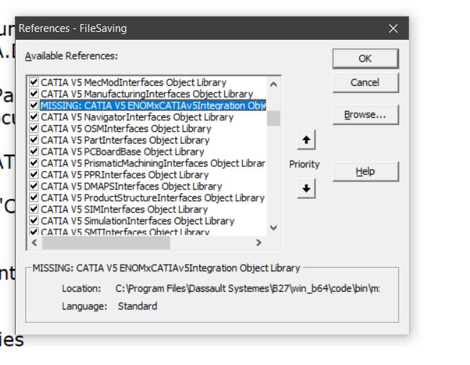

Sep 16, 2020 #2 LWolf Automotive Mar 20, 2007 504 SE did you check tools-references in VBA editor? make sure all the CATIA refs are ticked regards, LWolf Upvote 0 Downvote
Sep 16, 2020 #3 LWolf Automotive Mar 20, 2007 504 SE CATIA V5, I have a bunch of other CATIA that are not ticked, but all CATIA V5 are "on" regards, LWolf Upvote 0 Downvote

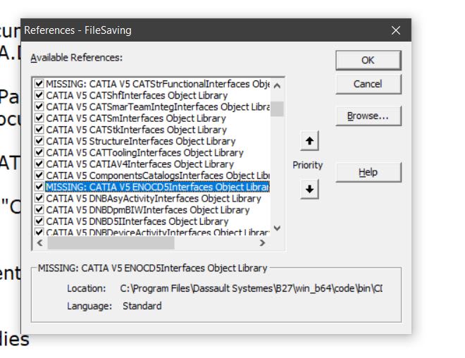

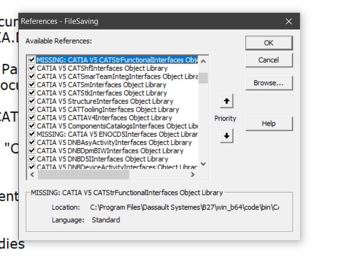

Sep 16, 2020 Thread starter #4 NaWin55 Mechanical Mar 21, 2020 97 IN Yes Everything is Checked But some references are missing i think i dont know why Upvote 0 Downvote
Sep 17, 2020 #5 Little Cthulhu Marine/Ocean May 27, 2018 716 RU Uncheck "MISSING" references and try running macro again. This problem happens when you move .catvba from one PC to another that doesn't have required products (CATIA modules) installed. Upvote 0 Downvote
