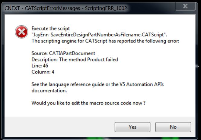

What is the exact error message that the Macro fails on?
During macro execution with display set to True I get the "Do you want file to be overwritten" and then "Save As will update the links" message.
Then when it gets to the CATShape item in the design the macro just bails with the error shown in the attached image to this post.
Source CATIAPartDocument
Description: The method Product failed
Line 46
Column 4
bails on: "Set oPart1 = oDoc2.Product"

Hi.
Change:
Code:
Dim oPart1 As Product
oDoc2.SaveAs docPath & "\" & oPart1.PartNumber & ".CATPart"
To this:
Code:
oDoc2.SaveAs docPath & "\" & oDoc2.Part.Name & ".CATPart"

Part can be inserted in a product thus creating an "instance". To enable this CATIA maintains product to product relationships and that's why we have Product property in PartDocument object.
CATShape contrarily can not be used to form an instance as it's sole purpose is to provide geometrical representation to both parts and products. Parts and catshapes are very similar in terms of internal structure, so PartDocument is used for both of these document types, although it's Product property for catshapes is unavailable (the exact source of your error in first place).
That perfectly helps me understand the macro error!
I did put in the changes and test ran the macro. It worked like a champ!
