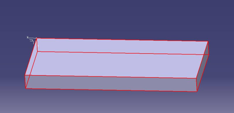

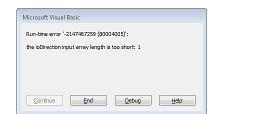

Hello guys , i am trying to get the edges on Y direction and to fillet them , i found some info on other forum and trying to combine but i am getting an eror and do not know how to solve it , please help :
the error is on refEdge.GetDirection dir

Dim dir(1)

On dir(2) it worked but selected only 2 edges out of 4 ... and on dir(0) and (1) same error like in picture above .
dir(2) is the dimension of the array dir : dir(0), dir(1) and dir(2) will be the 3 values that define the direction of the edge (like x,y,z)

you need dir(2) as refedge.GetDirection dir need an of dimension 3 so because you start counting at 0 you need dir(2) and it will always returns the 3 values: X, Y and Z.
it is not a filter to get only the edge along 1 direction

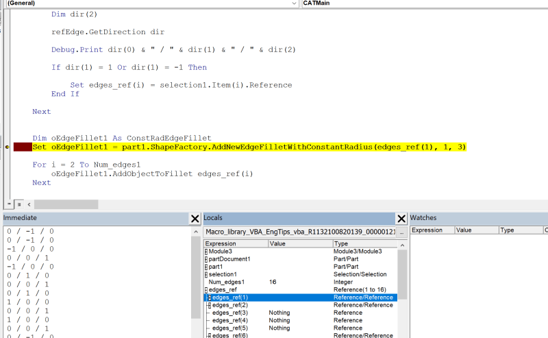

are you saying like this :
Dim dir(2)
Debug.Print dir(0) & " / " & dir(1) & " / " & dir(2)
If dir(2) = 1 Then ???
then you have an edge along Z
Eric N.
but it's not working ... this is what i am saying from begining
not sure if Direction is oriented.. you might have to check if you want dir(2)=1 and dir(2) = -1 ...

first of all please keep :
Code:
dim dir(2)
just because...
Eric N.
then run step by step and you will see it works :
Eric N.
it's the next part of your code that is not working
you set a fillet on the same edge:
Code:
part1.ShapeFactory.AddNewEdgeFilletWithConstantRadius([b]edges_ref([COLOR=#EF2929]1[/color])[/b], 1, 3)
Eric N.

also it seems the logic you want to apply is wrong... you search edges then you fillet some of them. I see a problem here as edges are defined by the solid composition, as soon as you create the first fillet, you change the definition of few edges, and your search done previously is just not usable.
I would search all edge, create first edge compatible with your criteria, then search again all edges.... I would use a while loop...
edited : the assumption above is false
you can select all edges, keep only the one you want and fillet them
let me know when you want the code...
