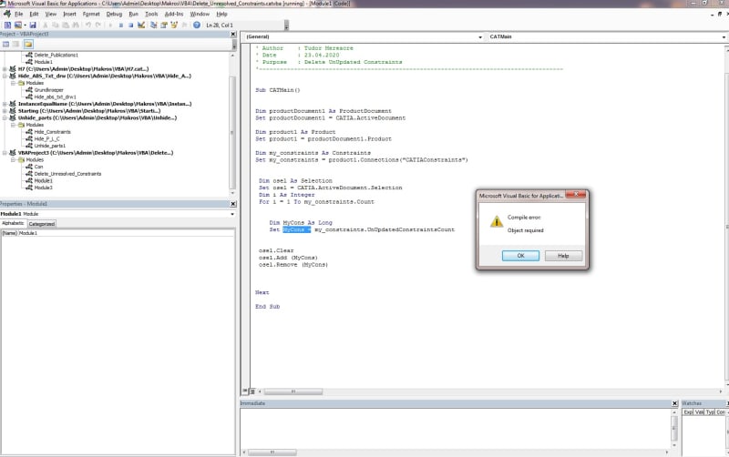

-Trying to understand the language , my first idea was to delete the broken ones and i saw that it is only a property name in difference so i just posted updated ones.
I really tried but still do not know how to join everything...? :(

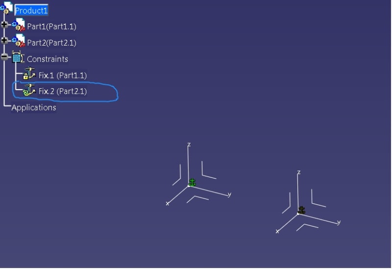

Thank you Fernando for your help , it has something to do with this :
and catCstStatusKOBroken , now i am really confused or maybe it's late...
So what i am trying to do is to delete this constraint wich requires update, maybe i didn't explained well....

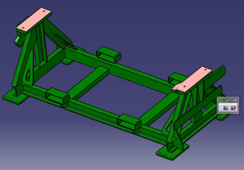

Hello Ferdo thank you for you response and i am sorry if didn't post right from the beginning, i will try to explain my thoughts :
For example i have done a welded structure like this
and it has a lot of constraints from the begining of the concept (when i started ) after a client review he wants me to do modify some lenghts for examaple and if i am moving elements they are asking for update and if they are like 100 its easier to delete and fix ( if you know what you doing ) . Also i saw that the call for UnUpdatedConstraintsCount property is same as BROKEN ones so i said to do one vba for UNupdated and next one for Broken should be similar.
I will try to implement what you sent, and if i succeed will post here thank you very much.

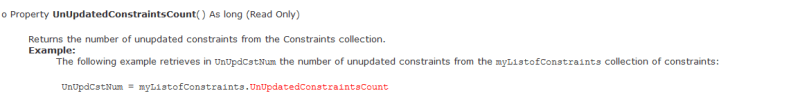

and i have a feeling that it must contain smth. with
o Property BrokenConstraintsCount( ) As long (Read Only)
Returns the number of broken constraints from the Constraints collection.
Example:
The following example retrieves in BknCstNum the number of broken constraints from the myListofConstraints collection of constraints:
BknCstNum = myListofConstraints.BrokenConstraintsCount
o Property UnUpdatedConstraintsCount( ) As long (Read Only)
Returns the number of unupdated constraints from the Constraints collection.
Example:
The following example retrieves in UnUpdCstNum the number of unupdated constraints from the myListofConstraints collection of constraints:
UnUpdCstNum = myListofConstraints.UnUpdatedConstraintsCount

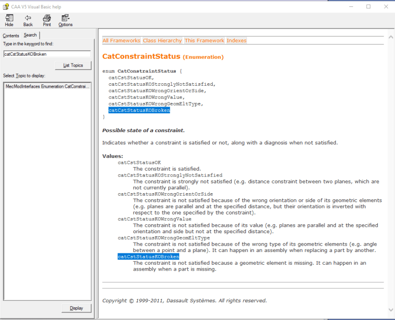

Cause i want to do one for UnUpdatedConstraintsCount and one for BrokenConstraintsCount (also i think catCstStatusKOBroken
The constraint is not satisfied because a geometric element is missing. It can happen in an assembly when a part is missing.
) has to do only for broken ones.

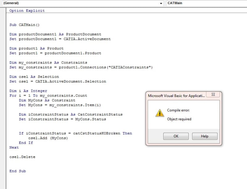

Sorry , i am new to catvba , but i really tried and cannot find solution this is last version how i am thinking it should be please have a look :
Please try with below code
Code:
Sub CATMain()
Dim productDocument1 As ProductDocument
Set productDocument1 = CATIA.ActiveDocument
Dim product1 As Product
Set product1 = productDocument1.Product
Dim my_constraints As Constraints
Set my_constraints = product1.Connections("CATIAConstraints")
Dim osel As Selection
Set osel = CATIA.ActiveDocument.Selection
Dim i As Integer
For i = 1 To my_constraints.Count
    Dim MyCons As Constraint
    Set MyCons = my_constraints.Item(i)
    Dim iConstraintStatus As CatConstraintStatus
    iConstraintStatus = MyCons.Status 'iConstraintStatus is an enum doesn't need 'set' keyword
    If iConstraintStatus = catCstStatusKOBroken Then
        osel.Add MyCons
    End If
Next
osel.Delete
End Sub
Make sure to check osel object count is greater than zero before osel.Delete
-Prasanna
It's just syntax error, you should not use "set" for non-objects:
Code:
Thank you guys , you are the best , helped me a lot ,works very good for broken ones last request how it should be for UnUpdated ones ??
I guess both broken and unupdated constraints comes under "catCstStatusKOBroken".
Prasanna
Ok finally i got it : for Unupdated needed this : {If iConstraintStatus = catCstStatusKOStronglyNotSatisfied Then}
