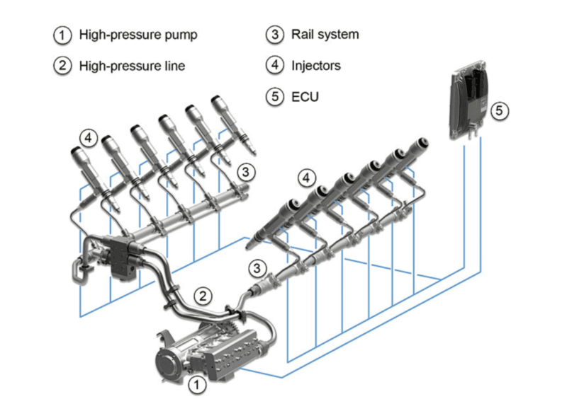

I have a carbon steel tube feeding a 4 piston recip pump, 65 psi to 40ksi. I experiencing extreme cavitation wear in the low pressure supply line. Short of putting an accumulator in the line, I'm looking for ideas to reduce the wear. Would replacing the problematic section with a harder material such as a hardened 400 stainless improve the resistance to damage? I usually move towards plastic or elastic coatings but I don't think they would be appropriate in this case.
~19mm OD. You can see the temporary repair.
Also, would adding ban accumulator to the line be a solution?
Can't help with your materials, but adding an accumulator would likely help. There's nothing worse than vertical up flow in any suction line.
This particular line is being fed by a gear pump and is pressurized to 65 psi. This line supplies a 4 piston reciprocating pump that outputs from 15,000 to 37,000 psi.
It's under warranty and the mfg keeps taking the failed parts so I don't get to investigate. I think a simple accumulator would fix the problem but I'd also like to avoid introducing elastomers. This is a diesel fuel injection system.

This is a common rail fuel injection pump on a diesel engine. The gear pump and piston pump are driven together on the same shaft. The tube buzzes loudly, it's almost as loud as the engine. Originally, the fuel pressure transducer was giving a fluctuating reading so the manufacturer replaced a section of the tubing with PTFE hose. Now the fuel pressure reads constant but the buzzing and erosion continue. The line fails after about 1000 hours of operation.

The fuel rate through this line should be close to the consumption of the engine which is 150 gph. The relief valve for the supply pump is before this line so it shouldn't see full supply pump volume.
The line in question supplies the pump #1 in the image but is not actually pictured.
Each injector has an accumulator on it so the high pressure side seems to be well damped.
I am not sure how rail pressure is regulated on this system. Other manufactures' systems use valves to time the start and stop point of each plunger's pump cycle. I think this system has a single inlet control valve. The buzzing starts once rail pressure is established so I know it's tied closely to that valve.
This engine is a new family and one of the girls follow units. It's also under warranty. The manufacturer is working on a solution but until then is replacing the line regularly. However, we have had a failure within the replacement window and the risk associated with atomized fuel spraying in to an engine room is unacceptable. I'm just looking for some ideas I can bounce off the manufacturer because it's been over a year and they haven't moved meaningfully towards a solution.

I think the cavitation is a result shockwaves from the control valve on the inlet of the high pressure piston pump.
If I was faced with this and not allowed to change flow related issues I would go with a larger line and use 2205 duplex stainless for it. It is a workaround for sure, sounds like they have a systems issue.

Artisi, I do believe the cavitation is caused by rapid accelerations.
