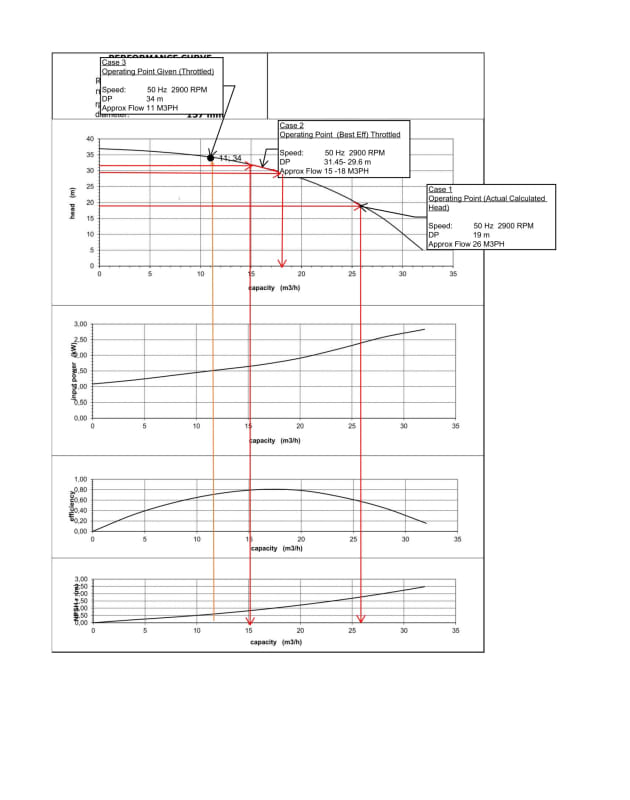

I have advised to run the pump with the performance curve attached near to the BEP-Break Efficiency Point.Which would cause some of the flow to be by pass in some cases to the tank.
The BEP is at 15 M3PH, according to the curve, the head required is 31.45 m.

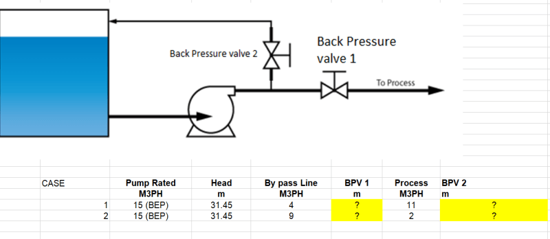

Now as suggested, install the back pressure valve or regulating valve at process and by pass line. Understand if installed at process line, it would be easy to simulate the flow and pressure, however now we have 2 lines (By pass and Process), How many % of the valve to achieve my desired cases below.
Assuming that i am using 1.5" inches pipe, what would be the back pressure valve for my case 1 and 2 ?.

Performance curve [Attached]
BEP is Best Efficiency Point.
Running close to that makes sense if all the flow is going forward.
As soon as you throttle some of it back to the tank you're essentially wasting energy.
You would probably use less energy at 11m 3/hr if you just throttled it.
To use a pump to flow 2m3/hr when it's designed to operate at around 20 makes no sense.

Your control system won't work on pressure. It needs to link flow to the bypass line control.
I agree, it makes no sense to force the pump to operate at it's BEP by wasting energy recirculating liquid. Just look at the curve you posted, case 3 uses less power compared to case 2, even though the pump is less efficient at that operating point.

Small pumps can be run far to the left side of the head vs flow curve for long periods without damage.
External recirculation is a good idea if you will be running at flows which are a small fraction of the BEP flow. It gives you one more knob to turn, in addition to a discharge throttling valve, to help the pump operate at a stable non-surging operating point. It also helps dissipate heat which builds up due to inefficient operation of the pump.
You could likely run that pump down to 5 m3/hr with throttling without any external recirculation. It would waste some energy, but not enough to justify bothering with a VFD. And you certainly don't need either external recirc or a VFD to operate permanently at your case 3 (15 m3/hr)
bmw318be - So? Your pump is capable of more than 20m of head. Don't blindly run at BEP when recirculating and assume that makes the system the most efficient. You need consider the efficiency of the WHOLE system once you start purposely wasting power/energy.
As for the valve % - they need to be whatever is required to produce the results you want. In the real world, this likely means some kind of automatic process control system to control the recirculation flow as the process demands change.

bmw318be, it's a good spread sheet to start.
If doing the calculation manually, you can calculate the hydraulic heads at the downstream of the valves BPV1 and 2 per pip size & length, flow rates, etc. And then, you need to know the BPV valves Cv for calculating the opening percentage.
As mentioned above, the instrument control system can be added to facilitate the operation.
