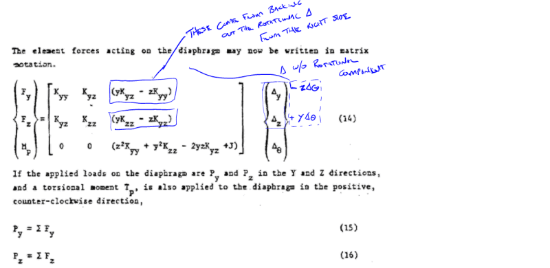

Refer to this thread for a stiffness matrix method: Link

Yes, the non-orthogonal wall works on my end. Non-orthogonal walls is actually the topic that led me to derive the method. The thread I linked to also contains a link to a spreadsheet I developed, it utilizes US customary units but it shouldn't be to difficult to modify for metric.

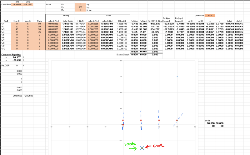

Do you get positive or negative YCR here?
Dik
I get a Negative Ycr for a configuration similar to what is shown in ops post.

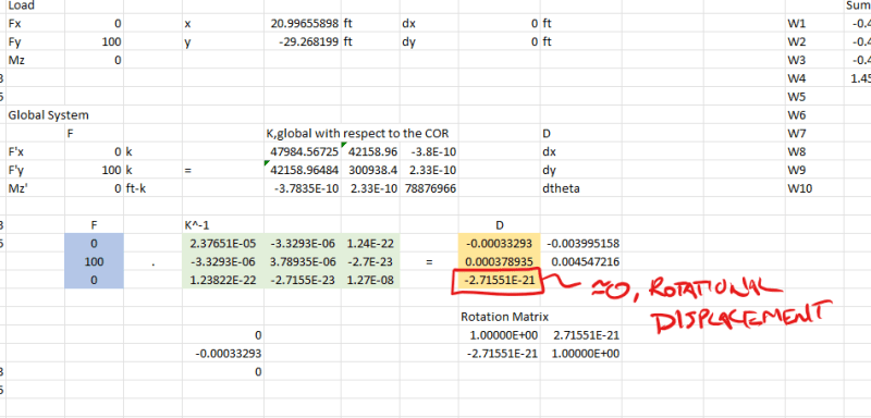

My test configuration:
Verification that the rotational displacement of the rigid system is 0 with the load applied at the COR:

Thank you Celt83.
It seems that the negative YCR in ETABS is correct then. I will have a look and see what I did wrong in my hand calc.
