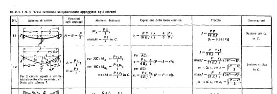

? if this is just statics ... the weight is supported by the two beams/columns ... like a simply supported beam. no??
If it’s two pins then it is simple statics. If the centre of gravity is half way between, then 50% of the load goes to each beam, etc.
Post your attempt at a solution and I'm sure we can provide some confirmations, criticisms, and/or ideas. This is a pretty simple statics problem.
Are you suggesting beam A and beam B carry the load equally?
Now what if the distance from beam A to beam B is 10 m while the distance of cog from beam A remains as it is, 2m.
no, we are not (suggesting the two supports carry equal load). Go look up a simply supported beam in any text. it'll show how the load is proportioned between the two supports.
in your example A reacts 80% and B 20%.
if this is a simple static problem ...
PS : better if you study a bit more
