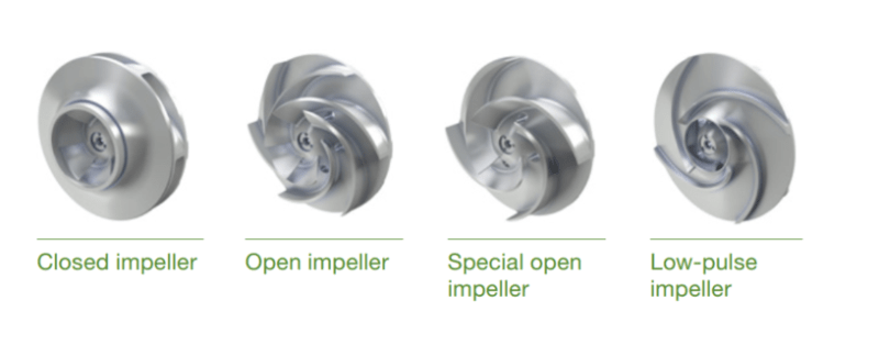

The current pump isan APT-33 with what is called a "special open" impeller. I'm not sure that extreme measures for low-shear are necessary, as this looks like a standard semi-open impeller with fewer vanes for larger passages. Looking at the design, does anything pop out to anyone?
From Petrowiki, Shell guideline for low shear applications is to operate at Ns < 700 (specific speed).
Would also suggest another derived parameter, given isentropic pumping power is near zero, that
z = P.(1-e)/M, where M = mass rate though pump in kg/sec, P = pumping power at pump shaft in W
be another parameter to compare with.
Parameter z will vary over the operating flow range, so you may want to compare the area under the curve if you plot z on the y axis against operating mass rate.
