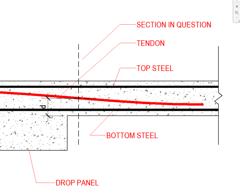

Celt, you are saying that programs like Concept will pick d to be the item labelled as d, not d' below correct? I think concept abides by this "by-the-book definition" of d as well.
I was chatting up their technical support on a recent PT drop panel job regarding the determination of d dilemma and received this response:
RAM Concept Tech Support said:
ACI 318 defines the effective depth as "distance from extreme compression fiber to centroid of longitudinal tension reinforcement." For the section in question, the section tension is resolved primarily through the tendon. For the governing envelope, there is negative moment and the tendon is near the bottom of the section (near the compression face). Since the tension is primarily resolved through tendon and the centroid of the tendon is very close to the compression most face, a low effective depth should be expected.
I do not have a ton of PT design experience, seems odd to me to even include the tendon in the determination of the height of d. Maybe a PT expert could explain this to me. When I was running my hand calcs for the shear design, I was taking d to be the distance to the top reinforcing in the section.

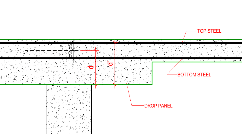

I think the section in question was similar to the image shown below.
I need to dig in more closely, but maybe all of concepts calculated 'd' values come from where the PT tendon is in the slab.
S&T
EDIT:
Scratch that, you have it correctish in your screen cap. Instead of EQ though it will be shifted based on the Area of top or bottom steel. Also of note is it will only be the lower d value if you specified a bottom reinforcing mat since the automated section design would design only the top bars there and the mat would only be present as user specified reinf.

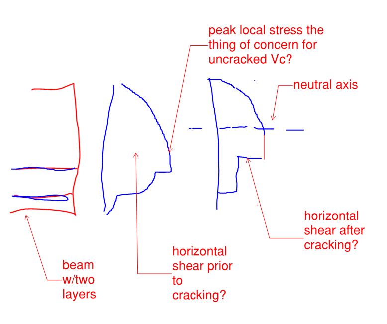

Meeeee too! I've been thinking about this on and off for years now. I doubt that I actually have the answer on this one but, at the least, perhaps I can stimulate some interesting discussion. Take everything that follows as being at least part conjecture.
1) In what follows, consider the two sketches of horizontal shear below, across a beam both prior to cracking and after cracking. I've probably screwed up the exact shapes but, hopefully, I've captured the salient features.
2) Vc.... ohhhh Vc. My understanding of Vc is this:
a) Prior to shear cracking cracking, you're trying to prevent the peak, local shear stress from exceeding the value that would initiate cracking. Check.
b) After shear cracking, we assume that the cracked Vc is the SAME as the uncracked Vc. Frankly, I've long been astonished at this. Hopefully I'm either wrong about it or it's been validated through some testing that I don't now about.
3) Based on #1 & #2, it seems rational to me that, for the purpose of calculating Vc_uncracked, which becomes Vc_cracked:
a) The most accurate estimate of the shear depth would be to the centroid of the tension force, including all reinforcement by way of strain compatibility.
b) The most conservative estimate of the shear depth would be to the centroid of the tension reinforcement since this increases your averaged shear stress (Vu/bd). Of course, this reopens the question of whether or not one should include rebar not intended to be flexurally active.
In both cases, I feel that you're looking for an averaged value (Vu/b*dv) that captures the peak shear stress value for the cross section prior to shear cracking.
4) My understanding of the minimum stirrup spacing is that the goal is to have a minimum number of stirrups cross each potential shear crack. This almost suggests that one could use the depth to the extreme tension steel for this purpose. That said, if our shear design methodology is based on the truss model, then each assumed concrete diagonal needs to touch down where there is sufficient flexural tensile capacity to restrain it longitudinally. And the lowest layer of steel cannot, by definition, supply that by itself. So, for stirrup spacing, I feel that the center of tension is again the most theoretically correct answer. All of this is muddied by the fact that your location of peak moment is not simultaneously your location of peak shear. At the end of a simple span beam, I think that one could argue that the shear depth, for the purpose of stirrup spacing, could be based on the flexural steel actually required at that location, not the flexural steel supplied at that location.
5) At the end of the day, we might just have to accept that shear design is rough stuff, particularly the conventional, non-compression fielded theory formulations of shear design. A truly precise definition of the shear depth based on theory is elusive.
I would say that the answer to your question is this: In my sketch above, the tension force contributed by the tendons affects the horizontal shear stress diagrams in much the same way as the mild reinforcement does. This gets a bit murkier when one give consideration to the potential for some of the axial prestress to get "bled off" into shear walls and other restraining elements.
