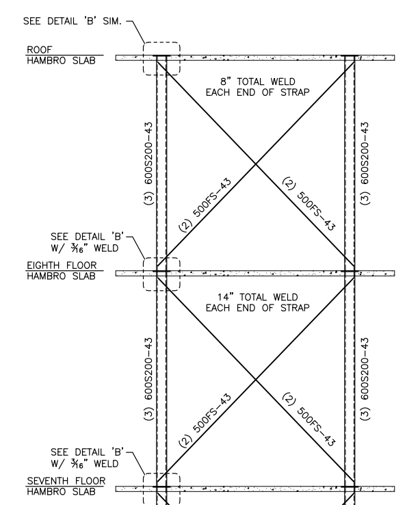

A colleague is looking for design information and details for cross-bracing steel stud bearing walls against lateral wind loads (no seismic). Detailed calculation would be handy. Can anyone assist or point me in the direction?

Geez dik....you're making it more difficult! Use 14 gauge sheet metal strips (4" wide) placed diagonally..for calculations, only tension in the strips and fastener shear need to be considered. Well...check compression/buckling, but shouldn't be an issue with diagonal placement.
dik...the other option is to double the studs and screw them together....overkill, but works.

What sort of fastener is usually used for the vertical component at the base of the angled cross-bracing? Does anyone make a bolt that can be epoxied into a gradebeam/wall and with an attached plate that can be screwed to the stud? Haven't looked at the AISI publications from SRE, yet. I assume there are load tables for the various manufacturers on site. I'll spec a particular manufacturer or an app'd equal.

Tapcons should be sufficient if you want to fasten to concrete. Usually only fastened to studs and track.

We typically use hold down similar to wood shear walls. the steel network has some info, as well as simpson.

I used to use a section of MC6x18 embedded in the track and epoxy anchored into the fdn. The strap was welded to the vertical leg.
At the top, I showed a heavy gage deep leg track for the length of the shearwall. The strap was then welded of screwed to it.

Here are some nice details I've found.
