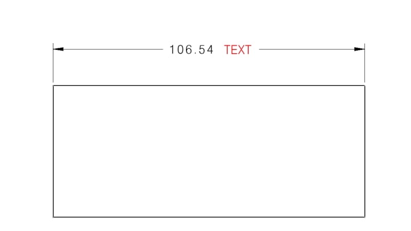

how to change the suffix colour and size of the CATIA drawing dimension.
Like I wrote a text on the suffix of any dimension in CATIA Drawing and now I want to change/Highlight that text.
I think the only solution is to have "spaces" as your suffix text, then put a "normal" text entry in that location.
You can then create a positional link on the text to the dimension.
It's not exactly what you want, but might be your only option.
Thanks Rickyt
With the text I can do , in this case I have to change only the suffix and prefix colour of dimension.
