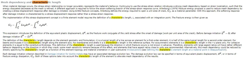

How can I calculate Characteristic element length and Fracture energy for Damage evolution in ductile damage module in ABAQUS?
Suppose that:
1-The model has S4R shell element
2- The finest element shape is like the picture
3- Type of mesh is Orphan mesh
4- Total Fracture area below the Stress-Strain Curve is 60
