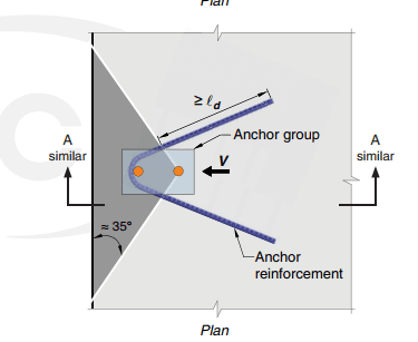

I would check the bar in tension for concrete breakout ignoring any contribution from the lacer bar.
Unless the lacer bar were developed back as per below, I would ignore it.

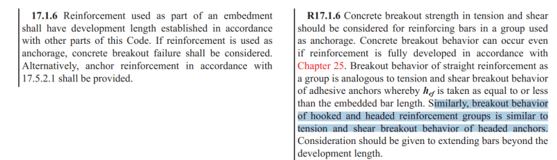

I am assuming the N16 U-bar is deformed rebar, and so you can check for tension and shear breakout of a hooked bar.
ACI allows the breakout capacity strength of a hooked bar to be equivalent to a headed anchor rod (see below).
