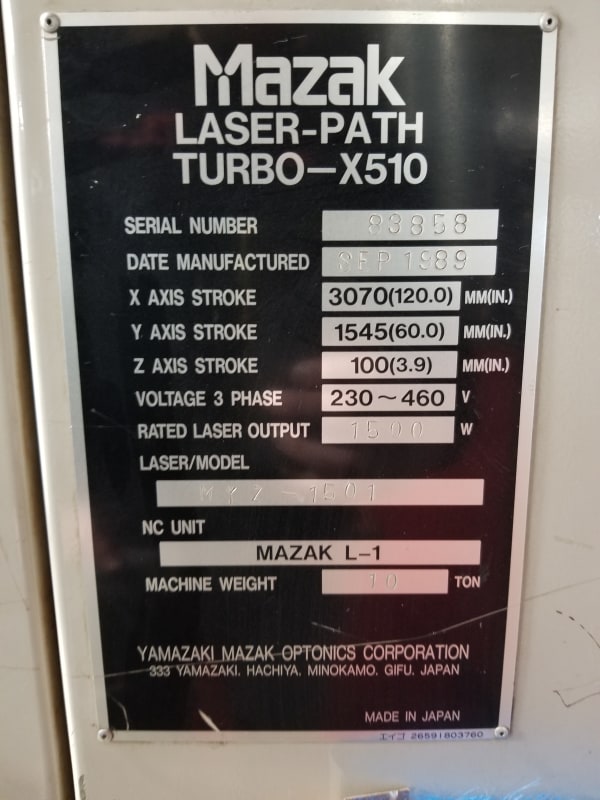

Hey everybody. We have an interesting and very frustrating problem with the water chiller for our cnc laser. When the compressor kicks in it is drawing current seemingly from the entire machine. The main problem is that this is drawing on the High voltage power supply for the laser resonator. When this happens it can lead to problems cutting since the beam power dips for a brief moment when the compressor starts. It's certainly understandable when the lights in your house flicker when a load is applied but this is an annoying problem for a piece of equipment. Here is what I can tell you. The compressor was recently replaced as the old one was deemed bad. This did not change anything. Main power coming into the machine is fine. The amperage draw on the compressor was said to be fine. I have swapped out the main transformer with a spare and that didn't help either. One thing I found odd is that I get ten volts running through each wire going to the compressor when it's not even on. This is after the contactor where there should be no voltage. Sorry if I haven't provided enough info and thanks for your time.

What does the machine placard state for power requirements of this machine?

Here is the tag from the electrical cabinet

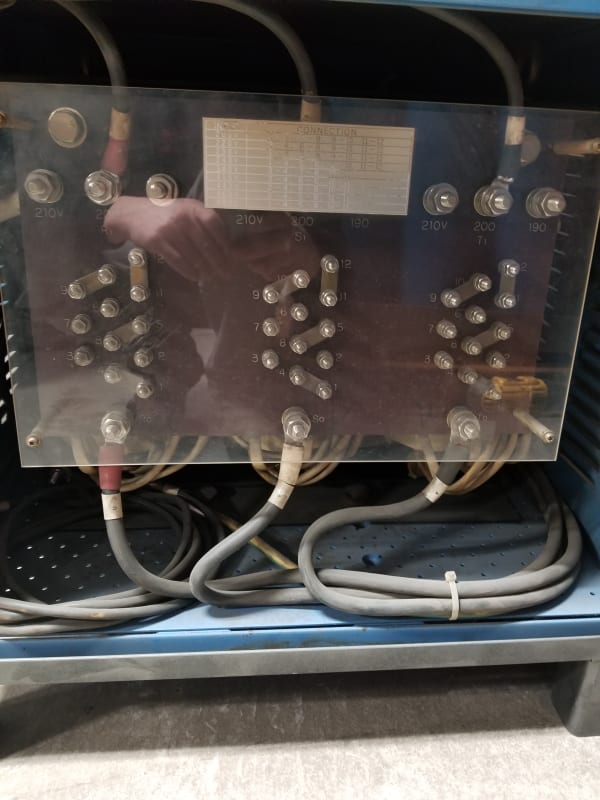

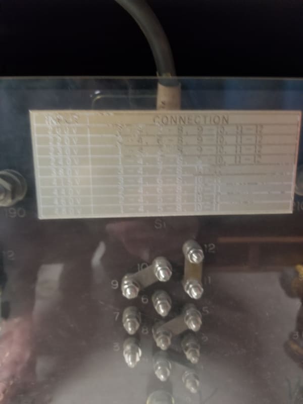

This is the main transformer for the laser.

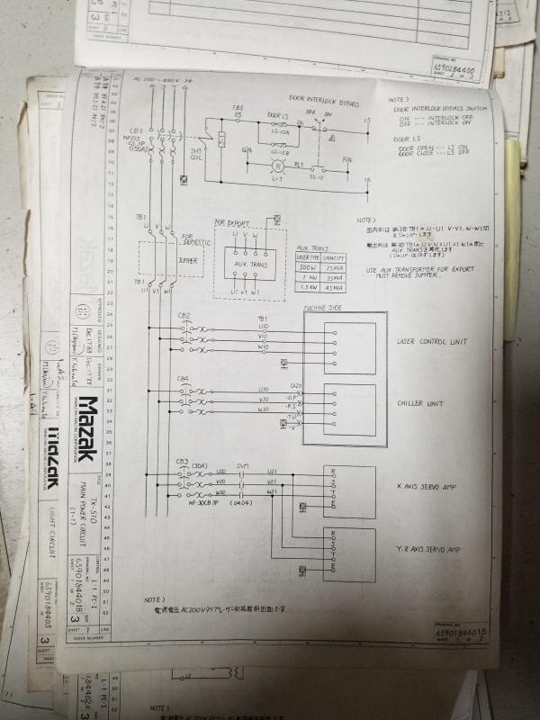

And here are a few wiring diagrams for the main power circuit.
I see the transformer can be tapped for 210,200 and 190 volts and is currently on 200. What's the reason for the three options? It appears it is also tapped correct for the 240 volts incoming.

From the looks of it in the first drawing, they use 200V for everything "domestic" which for them means Japan. Then for "Export" (second drawing), they add a 45kVA transformer to power the laser with 480V, but the chiller is still getting 200V, out of different taps of the SAME transformer. In the first drawing though, they show that a 1500W laser, as you appear to have, requires a 45kVA transformer. But in the second drawing, they are apparently using the SAME transformer, still rated 45kVA, but it is now ALSO having to supply the chiller. Nothing indicates the size of that chiller motor, but since that is the size transformer for the laser ALONE, my immediate suspicion is that the transformer is inadequately sized to handle the added burden of starting the chiller when the laser is running.
But... you say it's been working fine for years? Was the laser being used at a lower power setting then and now you are using it at full power? That would explain why it may have worked up until now. That's my theory #1.
Another possibility (theory #2): 200V motors are not common here in the US and EXTREMELY rare everywhere else (except Japan of course). So might someone have substituted a 230V motor, thinking "close enough"? So that scenario would go like this: original chiller had a 200V motor and worked fine for year, but eventually the motor wore out. You had someone replace it (HVAC company?) who was unfamiliar with the fact that Japan uses 200V and ASSumed that a readily available "tri-rated" motor here in the US, meaning rated 208-230 / 460V, would be "close enough". But it is not; a tri-rated motor design is actually taking a 230V motor and designing in a slightly higher tolerance to accept 208V, but NOT all the way down to 200V, at least not without consequences. One of those consequences would be higher than normal starting current. So the first motor worked as designed, but wore out, then the replacement was not the right fit and is giving you new problems.

240 Volt taps with a 208 Volt supply will be a problem. This is worth checking.
I see a 45 KVA transformer.
At 240 Volts that will be 108 Amps. That tracks with the 150 Amp breaker.
Transformer feeder ampacities are sized at 125% of the transformer, that makes 135 Amp rated cable.
For flexible cord that will be 2/0 AWG. That's a very large cord.
What to do?
Check the voltage at the transformer secondary while the motor is starting.
Check the voltage at the transformer primary while the motor is starting.
The diagrams are interesting but don't help a lot. The problem is probably outside the machine.

Pictures of all transformer nameplates will help.
