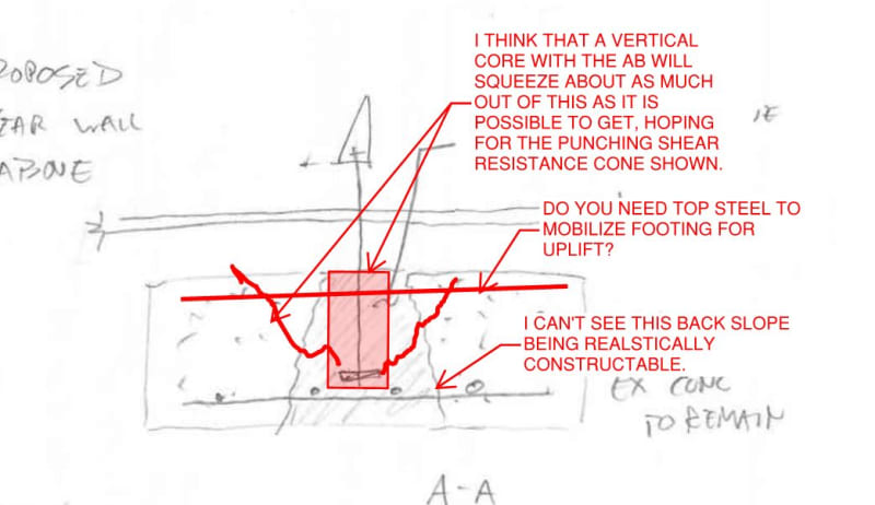

Can you describe you situation a bit more? Edge distances, available top rebar in your footing, what it is that you plan to embed?
I might be able to get behind coring a hole into the footing an embedding an anchor rod and washer set.
A sketch will improve understanding of the issue.
basic sketch attached.

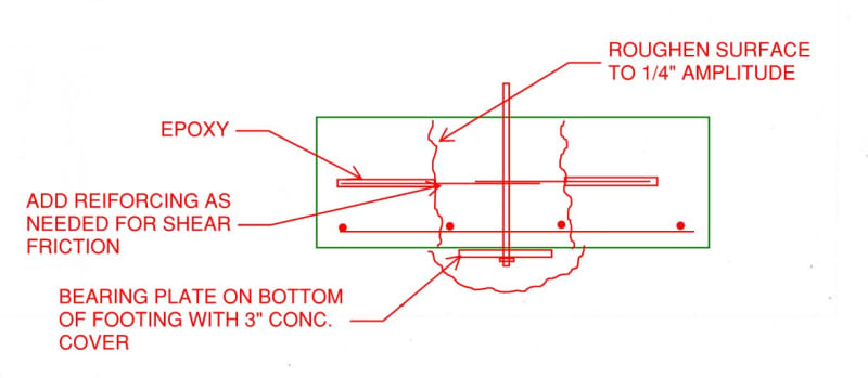

What about cutting all the way through, adding additional reinforcing for shear friction and turning it into a bearing/punching shear check rather than breakout?

This would be one of my go to solutions anyday of the week. The problem i see with this is accessibility where that opening would need to be rather large for drilling equipment to make those holes. Alternatively to this would be to make some horizontal holes completely thorugh the footing to "clamp" it together. I'm anticipating the footing to be a 3 foot square by maybe 18 inches deep. This would make for a lot of drilling.

this is existing conditions and i'm estimating based on quick load take down that there is at least a 3 foot square footing under this post. Thickness, i'd guess 18". the size of the pad is not for uplift resistance. The uplift resistance will be resolved separately, through connection of a grade beam. I will need to post more information and i understand my descriptions are vague but i was mainly concerned with teh concept of chipping away and pouring in new concrete if that would effectively restore a cast in place strength.
