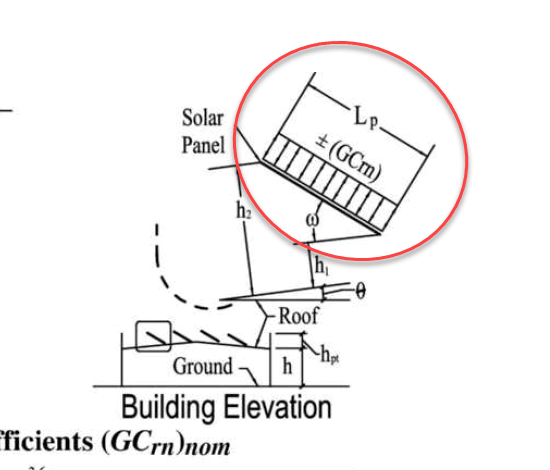

When panels are not tilted, what determines chord factor and/or Lp value? I cannot find anything in the code other than Fig 29.4-7 which doesn't do a good job of explaining this?
Is it related to the direction of the array frame supports, landscape for running long direction of panels and portrait for running short direction of panels? Does direction of roof slope have bearing on this Lp factor?
Also, when Lp > 6.7ft, is the only way to compute values on the panels to do wind tunnel analysis, or forced to get smaller panels to avoid wind tunnel analysis?

Why does Figure 29.4-7 show Lp going the direction of the tilt?

If there is a 'high' side and a 'low' side of the module, the distance between them along the chord is Lp.
Its based on the total slope of the module including roof slope. For you your module us flat so its just the roof slope that changes the heights of the modules.

I'm just interpreting the figure.

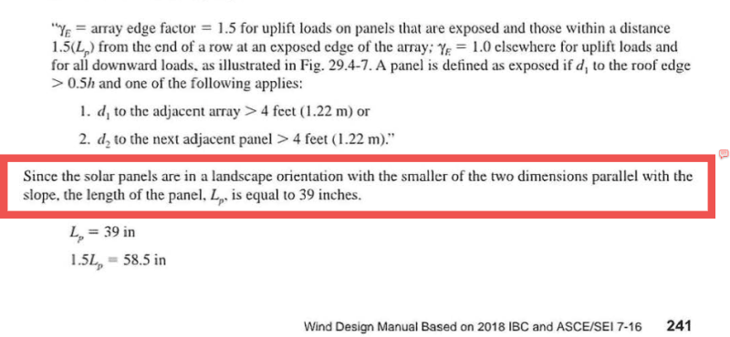

So, I spoke with engineer for Roof Tech. He believes Lp is the length of the tilt, weather it's a tilted panel or parallel with slope, from bottom edge of panel to top edge of panel. Still to be confirmed, I suppose.
Thanks for the dialog!!! I appreciate it.
Looks like I found Lp from the Wind Design Manual Based on 2018 IBC and ASCE 7-16
