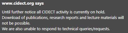

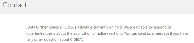

I was looking into a connection into HSS, and noticed that one of the checks for wall thickness is not from CISC or AISC standards, but is instead from CIDECT. However, I went to their website to get their design guides, but it states that all activity is on hold and all downloads and contacts are on hold as well. Does anyone know how long this has been going on for? I don't want to end up having to pay for a design guide online from like scribd, when they used to provide it for free.
With them being on hold, how does it affect their standards? Are they still enforceable? There is nothing in CISC for this specific check stating you need to consider it but RISA is obviously checking it for a reason.

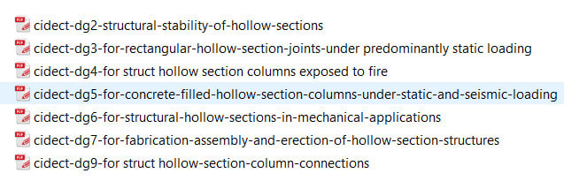

from CIDECT I have (PDF): "hollow sections in structural applications" - Wardenier - 2001 and same title but Wardenier/Packer/Zhao/van der Vegte - 2010.
They are copies free of charges - for educational purposes only.
Furthermore "structural stability of hollow sections" - Wardenier/Yeomans/Rundel/Wurker/Dutta -ed. Verlag ed. CIDECT(where, at beginning,there is a title-page 'CIDECT construction with hollow steel section' - 1992).
Ready to let you have a link for download
All the links appear blocked.
The error is still happening at CIDECT. I am interested in reading the information in Design Guide 3. Does anyone know how to find the information? Thank you.
Josh, click the download button on that site and see what happens.
I succeded in downloading the following doc : let me know if I have to share the links

Ahhhh, I thought the whole website was broken, not just the downloads. Sorry for the confusion.
I have a downloaded copy of some of the pdfs that I could send to someone in private. I won't post anything on line because of potential copyright issues. I've got DG 1, 2, 3 and 9.

I also have all of the CIDECT design guides, so if you are having trouble finding one, let me know and I'm sure we can figure out a way to share it.
