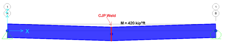

Yesterday at 9:18 PM #1 A Aldsap Structural Dec 24, 2024 2 Hello, I have a W24x68 steel beam. I have to make a slope for roof drainage. We will cut the beam in 2 and drop the center. I have a Moment of 420 kip*ft. How do you calculate the CJP weld to confirm its enough to join the beam ? Thank you for any help
Today at 9:05 AM #2 kingnero Mechanical Aug 15, 2009 1,769 Why cut & weld if you can simply bend the beam? And a CJP weld (if done correctly) is always as strong as the profile itself. Upvote 0 Downvote
