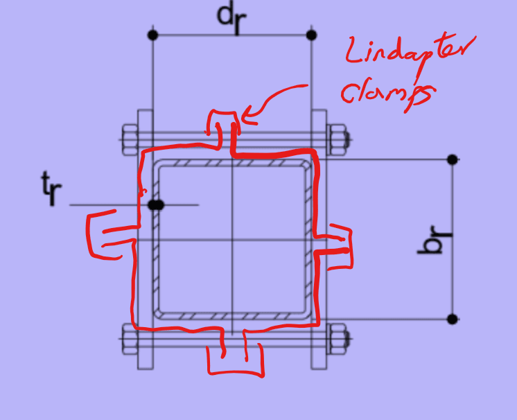

On a recent project, I require plates clamped to an HSS column with friction providing the vertical capacity. They don't want to drill or weld on site. I've attached a sketch of the connection. Any suggestions about maintaining the clamping force (my preference is Loctite Red) and determining the coeficient of friction? The material is HDG steel and the bolts are A325s. It is exposed to the elements and will probably cycle from -40C to +60C. One solution I haven't broached with the client is to use powder actuated fasteners with thinner clamping plates. I don't know if that is acceptable. I can easily calculate the crushing load of the HSS column walls.

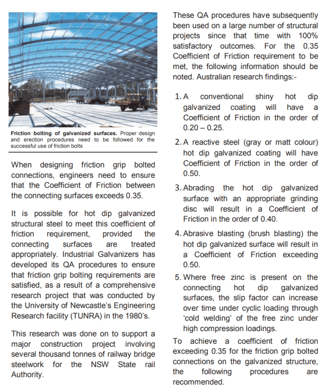

Some points regarding coefficients ; EN1993-1-8 suggests μ ( varies from 0,2 to 0,5) and EN 1090-2 suggests μ=0.4 for Surfaces blasted with shot or grit and coated with alkali-zinc silicate or thermally sprayed with aluminium or zinc.

Think I'd be contacting Lindapter to see if they have done anything similar. My gut says with that temperature range, any solution will be difficult. How safety/stability critical is the connection? Using a fabricated half-box sections that could fail in slip, but then rotate and jam could give a 'fail safer' mode rather than two flat plates.

If you can get your hands on the TIA-222 code, they offer some guidance for u-bolt friction connections which *may* be of use here. IIRC, square bend u-bolts too.

Here's some published values for the COF: Link

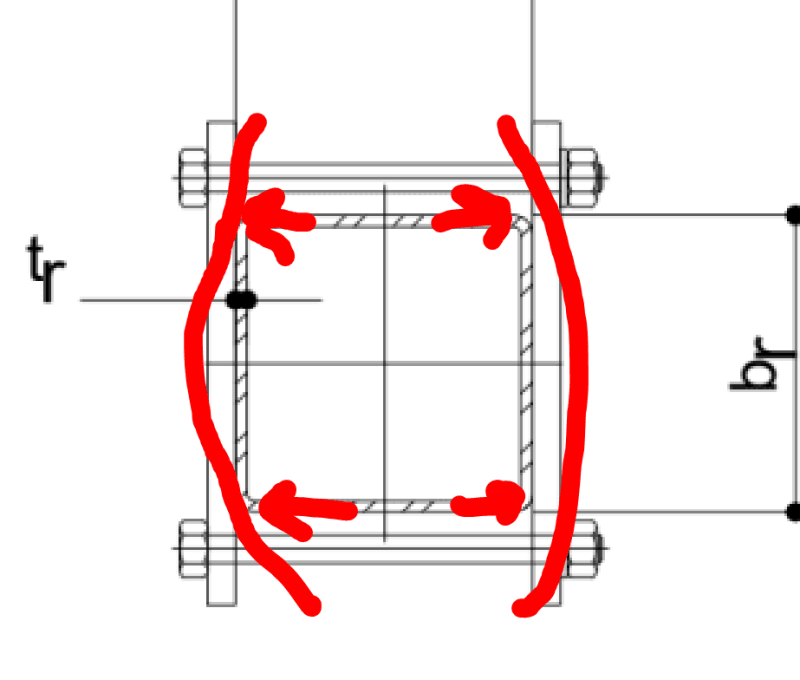

One thing that plays in your favor a bit, I think, is that the plate deformation should focus the clamping reaction right where you want it: over the HSS webs (sketch below). Granted, the tube radii mess with this some.

Thanks Koot... I was thinking of stiff clamp plates with holes for PAF, if needed. The thick plates are to minimise deflection. I think torque to determine bolt tension and maybe squish washers... still a work in progress. I was thinking of a COF of 0.2 to 0.25, but am still digging up info. I'm leaning towards small diameter bolts with bottom chamfers. It's looking pretty good and am more confident than I was yesterday.

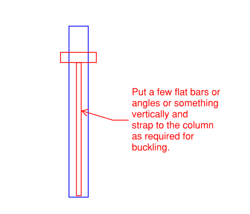

Where is this located vertically? If it's a few feet from the top or bottom could you cheaply create a secondary (or primary) vertical load path? maybe something like this? Basically, run a few baby columns for your item and strap it to the main column for lateral support. If it's close to the top you could just throw a couple of hanger rods in and call it a day.
