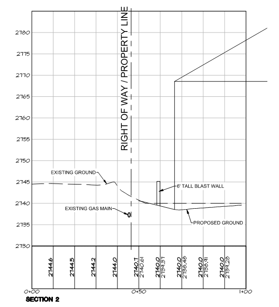

I am working on a Department of Housing and Urban Development (HUD)project where I need to design a 6 ft high concrete masonry unit (CMU) blast walls. The requirement of the blast wall (and its material) is as follows, "Thermal heat flux exposure threshold of 450 BTU/hr/ft2 for people in open spaces where people congregate, such as parks and playgrounds and blast overpressure threshold of 0.5 psi as the maximum allowable pressure that can be measured at a distance from an explosive hazard applicable to outdoor unprotected facilities." I designed a cantilever cmu wall for the 0.5 psi (=72psf) and got a solid grouted 8-inch CMU wall with #4 rebars @16 inch O.C. vertical rebars to work for 72 psf pressure. This does not seem like a strong wall so I am not sure if there is more to the loading that I am missing. I would like the expertise of the community on this and also what I could do for the 450 BUT/hr/ft2 requirement. Any relevant information and design examples would be greatly appreciated.

To add to the topic, this is for a housing project. Typically they would not require a blast wall. However, they need a blast wall because this is HUD-funded housing. The wall is trying to provide cover from a gas pipe blast in the ground at a depth of ~5 feet and at a distance of ~12 feet. The 0.5 psi refers to the incident pressure. I have attached a section for reference.

phamENG: I am using the document that you referenced " Barrier Design Guidance for HUD Assisted Projects Near Hazardous Facilities" as well. However, most of the documents (including the drawing provided by the client) that I am referring states to design the blast wall for 0.5 psi and 450 BTW/ft^2-hr. I will check this again. Don't you think if the wall can handle 0.5 psi pressure then it would resist the pressure and there would be no blast pressure beyond the wall? The exception you provided is going to be a big help. According to page 4, I would not require a blast wall in my case. I will discuss this with my client and see what we can do. I appreciate the help phamENG!

That document states that those are the thresholds above which serious damage is likely to occur to a typical building. You only need to install a barrier if the setback to the hazard cannot be established to keep the impacts on the building below those values. The goal of these design criteria is rarely to keep the building in pristine shape - it's even okay if it has to be torn down afterward. Just so long as occupants are not seriously injured or killed when the extraordinary event occurs, the structure has done its job.
If you need to design it to resist a blast form a gas main 50 feet away...good luck. Those values will be significantly higher. Like an order of magnitude or two higher. The trouble you'll find, I think, is determining the volume of gas you need to account for in the explosion.
