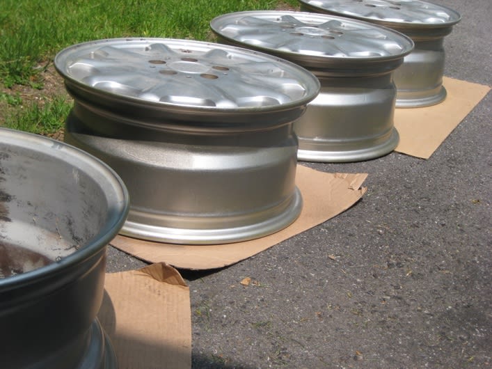

The alloy wheels on our '98 Mercedes had rims leaks. Cause was corrosion in a few spots in bead area. Originally rims were coated with some sort of paint that sanded easily but was well adhered. My first effort was to sand out the corrosion, roughen the surface and apply a 1-part polyurethane moisture cure coating. This worked to some extent, but adhesion was not uniform.
I decided to strip the rims from outer edge down through the bead area to the inner rim. (about 2" wide area). I tried various methods of stripping, but in the end rotary wire brush was only thing that worked. But it left a rough surface that I still need to sand smooth.
So now I should have bare aluminum with hopefully a relatively smooth matt surface finish.
Environment:
- outer edge of the rim beyond the tire is exposed and could see salt and water.
- surface that tire rubber bead seats on may have crevices and subsequent corrosion (as occurred on original rims)
- surface inside tire bead could see moisture that condenses from air.
- the bead surface needs to be hard enough to not be damaged by tire bead pressure or movement.
Finally my questions! How do I best finish the job?

Coatings cause crevice corrosion on aluminum. If you aren't going to go through the extent of using a chromate conversion coating, you're better off leaving it bare.

Any coating would need to be available retail in Canada. Marine (and other) stores have zinc phosphate primer for use on underwater aluminum stern-drives and other aluminum surfaces. including the Temp one I mentioned earlier. This one I can get from local store: It likely doesn't have much corrosion resistance on it's own, so would likely need an overcoat.

Today, I am going to continue with the sanding and polishing of the bead areas. I will put rims on one at a time on a car in garage and spin the wheels while sanding with several grades of paper until I get an acceptable finish. That will get me back to making a decision on what coating, if any, to apply. Seeing rims won't be used immediately, maybe I will use a zinc phosphate primer followed by a light coating of the marine paint as used on boat outdrives. The rims should then at least look good while in storage :) Paint will have a long time to fully cure and dry!
I see. In that case, I would inclined to coat the bead area with your zinc phosphate coating and let it go at that. When I worked in the aircraft wheel and brake business, procedure was to strip the paint during overhaul in order to facilitate penetrant inspection, then re-paint, which obviously included the tire bead area. Of course, the minute movement of the tire during service would chafe the paint over time, so it was a losing battle.

I have completed 2nd to last step. Coated interior of rims with zinc phosphate primer.
I chose a Moeller marine product that is made to be used on outdrives and outboards. There is a similar product by Tempo, but it was not available locally. I compared the Moeller with the Rust-Oleum self etching primer they recommend for aluminum. The Moeller SDS says it has 3-7% zinc phosphate. Rust-Oleum 1-1.25%. So I went with Moeller.
They say to put just a thin coating on. It sprays well and does not run. Masked first one, but found that was not needed. I will apply a Moeller top coat that is also used for underwater drive units. Have to wait at least 24hrs before overcoating, it seems.
Just to conclude. Painted the rims today with Moeller Honda Oyster silver engine paint.
I have new aftermarket rims on car, so these will go into storage until needed.
