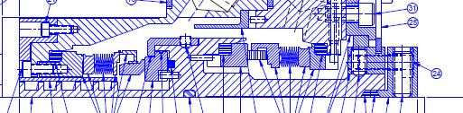

Hello All,
Most of the Cocker charge pumps are supplied by Arrangement-2 of API 682 seal. It means plan 23+52. The experience shows using plan 23 with Gas Oil is super expensive and plan 52 is not a suitable plan in terms of safety and reliability. Another option is to use plan 23+53B, however still we have to use expensive flushing by GO and the issue of cooling during hot stand by condition remain. Does any body have valid running experience with plan 54 without using plan 23? In this case either bac-to-back or face-to-back should be used, however the issue is the process liquid is in ID of seal rings and this is not recommended by API 682, Appendix A. Also, those arrangement have other issues such as risk of O-ring “hang up" and poor pressure reversal capability.
Any experience with plan 53B and "face-to-back" arrangement without using plan 23?

We have three cokes with a total of six charge pumps. The newest pumps use a plan 54 system with a full skid with pumps, coolers, filters, tank, etc. This plan was worked pretty well. We have had two events where they allowed reverse pressure on the seals which pushed tar into the barrier fluid. We have made procedural changes to try and prevent this. Both pumps share one common system. We are considering adding a smaller system for the spare pump to separate these.
Our two older cokers have single seals that use Plan 32 (outside gas-oil flush) and steam quench (Plan 62). As you noted, this flush plan is outrageously expensive in terms of lost gas-oil. Eventually, we will probably be converting to Plan 54 on these four pumps as well.
All of our seals are high temperature bellows seals so o-ring hang up is not a concern. The seals in the new coker are not balanced for reverse pressure. The inner seal is a stationary bellows with product on the ID. This may have contributed to failures. We are considering design options to address this.

Hello JJPellin, Thanks for sharing your experience. May I know where is you plant location and who is the Vendor for NEW seal cartridges and plan 54? How long are you using plan 54 for the pump? Any failure after modification?
We have three Flowserve cocker pumps (BB2, ~ 13OOkW), originally have been used JC seal with plan 23+52, however we changed one of them to plan 23+53B with Flowserve seal (Face-to-Back arrangement, see Figure 5a of API 682). This change did not solve the cooling issue of the seal during "hot stand-by" and after shutdown. The other option is to add a small circulation pump with plan 53B. However, I personally prefer to use plan 54 without plan 32.
Due to super expensive of using GO for plan 32 (> $300K~1M depends on flow rate, min 8l/min), I am thinking to use plan 54 with "face to face" configuration (See Figure-5c of API 682). Are your new cartridges are "face-to-face"? You wrote The inner seal is a stationary bellows with product on the ID. The issue is: API 682 recommends "face to back" configuration for arrangement-3 because by having liquid on the ID of seal, cause centrifugal forces pushes all particles, dirt, cocks, etc toward the seal rings contact centerline. This is not recommended for this dirty service. I am thinking to use "face-to-back" arrangement of API 682 (See Figure-5a of API 682) and ask seal Vendor to design a deflector to let flush and cool the inner seal and plug the external flush port on the cartridge.

Our Plan 54 system has been in operation for about 5 years. We do not use the gas oil flush (Plan 32) since then. The seals are John Crane. I have included a partial drawing. I would describe this as face to face.
We have experienced a number of failures in the past 5 years. Probably 5 or 6 individual seal failures. They have generally been associated with high heat, plating out the barrier fluid on the faces of the inner seal. Our pumps are two stage, between bearings, approximately 600 HP. We are located in Minnesota, USA. We are redesigning our seals to increase the flow of barrier fluid toward the inner seal.
