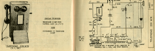

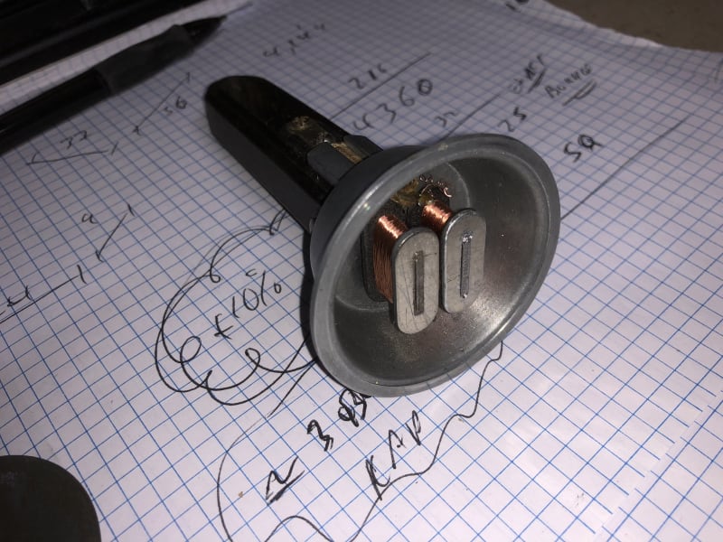

I am restoring an old magneto phone.

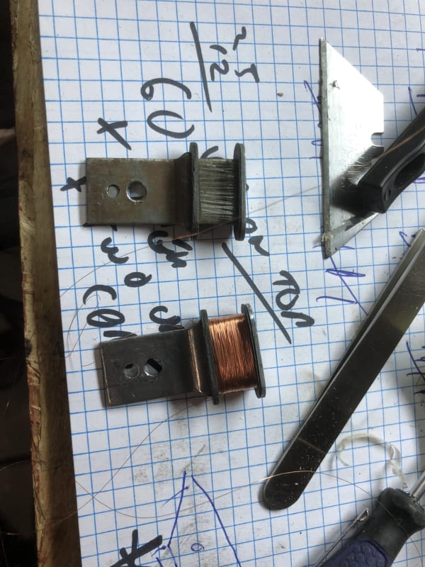

The coils in the receiver are dead (well I found the actual problem when I took one apart ... one end of the coil was just cleaned of insulation .... laid against the core of the coil ... and windings put over it .... 100 years of corrosion and there was no connection ... very bad design).
So, I carefully took off the wire, counting the number of windings.
I also measured the length of wire.
Just FYI .. the magnetic wire measured .005 and measured 81 ft and 44 ohms ... so from tables it is #37 wire
So my question .... I can't believe I will perfect and get the exact number of windings from 81 ft of wire.
Is it more important to get the coil count right or get the length of wire right?
Thanks so much .... Mike

1. The conductor gauge shall be the same or thicker,
2. The number of turns shall be the same,
3. The length of the conductor is NOT important. The new winding may end up with longer or shorter length. Therefore, the resistance may be different from the original. As the conductor gauge and the number of turns are the same as the original, the length and the resistance is likely to differ from the original, but minimal.
Che Kuan Yau (Singapore)
Agree with che. Get the wire cross-section area (gauge) at least the same as the original, if not one size larger. Wind with the same number of turns (produces the same magnetic effect). When winding - get the new coil as tight and uniform as possible to help concentrate the magnetic effect. Might also help to put a very thin ground wall layer next to the iron core (probably wasn't there in the original) - a sheet of mica-based insulating paper (nominal 0.020 inch thickness) should work just fine. Overlap the ends by a bit, and fasten the "loose" end with some tape.

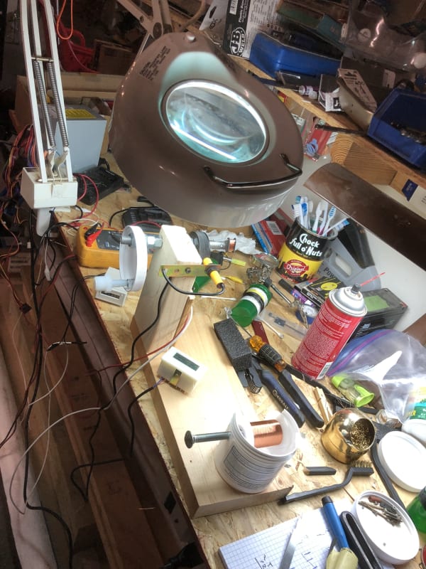

I finally got around to winding the new coils.
All my tools are in storage while I build the new workshop so I had to do with what was around the house.
I bought a cheap counter to keep track of the winds.
In the end, it came out perfect.
Almost identical to the original and both are matched.
The issue seems to have been with the original way they built the coil. They just took the insulation off and let the first few winds make contact with the core. After 100 years of moisture and such, the connection just had some corrosion. I cheated a bit and left a tail out on the new coil. The then jointed the tails of the coils together (the two coils are in series).
