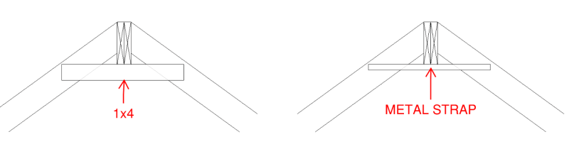

I've been asked by one of my contractor clients about alternatives to collar ties for rafters in a space with a desired vaulted ceiling (residential construction). The contractor doesn't want to use the prescriptive minimum 1x4 wood framing due to loosing some ceiling height. The rafters are connected to the ridge beam with just nails, so I'm not inclined to try to justify this (even with more nails) because of the withdrawal loading that would occur in the case of wind uplift. I am however considering the possibility of using steel straps in the same manner as a conventional collar tie. They would be positioned directly below the ridge beam, oriented horizontal, and connect opposing rafters just like collar ties. Straps are convenient, cheap, and low profile so there would hardly be any loss of ceiling height if positioned right under the ridge. In my head this works if the straps are installed without much slack because this is purely a tension member. Has anyone done this before? Is this a bad idea?

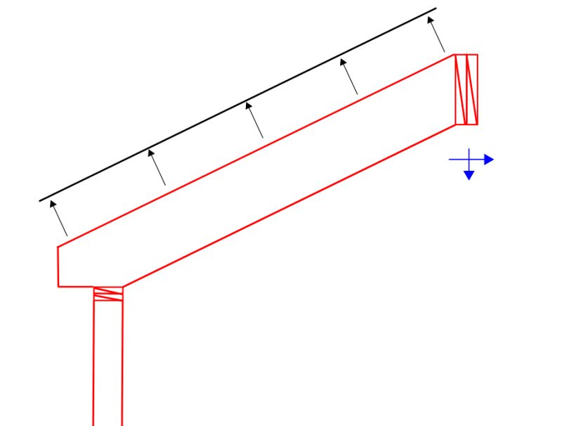

There is a double ply beam at the ridge that will resist vertical loads from the rafter ends at the ridge. The low side of the rafters are supported by wood stud walls. I have sketched this up below, showing only one side of rafters for clarity. What I am seeing is that the horizontal component of reaction force at the top end of the rafter needs restraint somehow. My thought is that using a collar tie (or similar) will provide this restraint instead of relying on dowel type fasteners in withdrawal.
Some form of restraint of the rafters at the ridge is required whether it's a ridge board or a ridge beam. The beam only negates the need for rafter ties. With no collar tie, your toe nails for the rafter into the ridge beam are in withdrawal under uplift loading - gross.
TRAK - your idea is not original, but a little off the mark. What you want are ridge straps. Check out the IRC - Figure R802.4.5 and section R802.4.6.
I agree with Trak here, I think what most are missing is that the uplift is usually resolved by some minor capacity associated with a facemount/topmount hanger, but because there are no hangers on this project, and the joists are simply toe-nailed into the ridge, we are missing that uplift resisting component. Trak, what about A35's alongside the rafter to the ridge, is there room to install that? It's a much better connection than a toenailed connection anyway, for vertical loads, I would make sure to mirror it on top and bottom though, depending on rafter depth.

I'm confused, is this what you're proposing?
