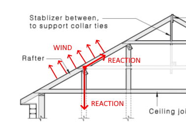

What is the structural logic driving the blanket rule for collar ties at every underpurlin? How do people get around the rule eg attic conversions?

So in your context, it makes some sense. Look at a free body diagram of the roof. You'll have a reaction at that point that isn't always vertical. So that collar tie provides a horizontal reaction that helps resolve the non-orthaganol loading. (Particularly important for wind, which is often asked to act perpendicular to the surface.)

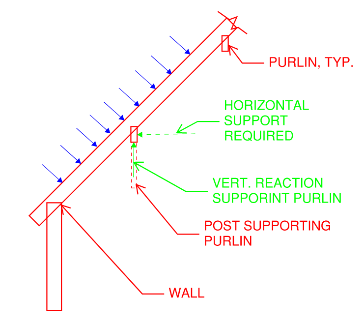

Tomfh - in the case of wind load applied normal to the surface of the roof, it can't be resolved along the rafter because it's at 90 degrees to the rafter. See the sketch below. The purlin supporting the rafters has to either span between two supports capable of resisting vertical and horizontal load (such as large timber trusses), or it has to be supported by discreet members. I get the impression that the code section you cite is referring to light frame construction where heavy timber trusses would not be used. So something has to resist that load - enter the "collar" tie (as your code calls them - again, rafter tie in the states to keep things clear). There is probably an argument to be made for diaphragm action, but it's my understanding that in your part of the world it's common to use flat strapping with large gaps and roofing overtop of that - correct? If so, I wouldn't expect as much diaphragm action as a fully fastened field of plywood.

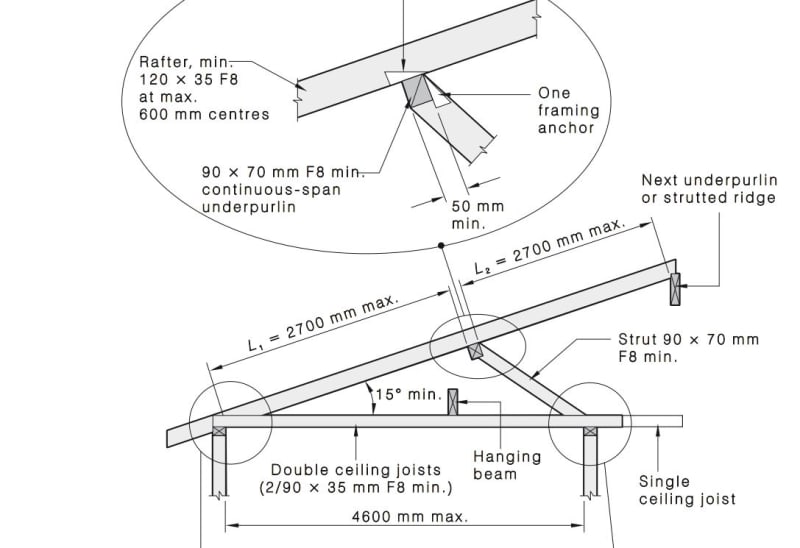

From a structural mechanics point of view the horizontal component going into the tie could be resolved along the rafter. :
There are many other cases in the code where this explicitly occurs, i.e. where a strut (or beam) is supporting a rafter at angles other than 90 degrees. E.g. here in a non coupled roof:
Is it the rule in your code that struts must be at 90 degees to rafters?
Also, these collar ties are just ties. They're not required for gravity/downward loading. The code nominated collar ties will often have close to zero compression capacity, so it's a tension thing only, as far as I can tell. I still don't understand why each and every underpurlin needs one.

I think that I've got this now. New hypothesis:
1) I still feel that this is primarily for gravity loads.
2) I propose that the intent is to create "trusses within trusses" as shown below. This, to accomplish the following:
a) I imagine that one designs all of the rafter supports to carry, roughly, equal shares of the gravity load. Without the tension ties and the faux trusses that they create, I would guess that the stiffness of the red truss below would tend to dominate over the flexural stiffness of the underpulins.
b) Using the "under trusses" to shield the red truss from excess load also shields the rafter to ceiling tie connection from excess load.
