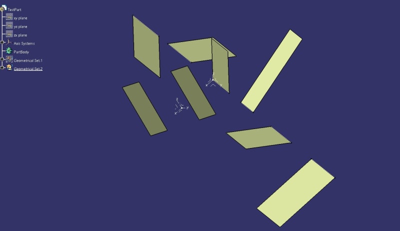

Hello all
i need to collect only vertical edges from surfaces like this (below image)
i tried one method it worked like 60% but i need to collect only vertical edges regardless of any axis orientation

Hello all
i am sharing a reference cad model, what i m working on is trying to creating blend between surfaces using a macro
user will select a all the surfaces required for blend and code will look for correct blending edges and blend will be created
for this i am trying to extract only vertical edges but that will be difficult because axis orientation may change or edges angle may change
i tried calculating the distances between lines which one gives the smallest those lines will close together and can be used for blend but that might not work al the time
is there any other way
my goal is here to create blend using a macro

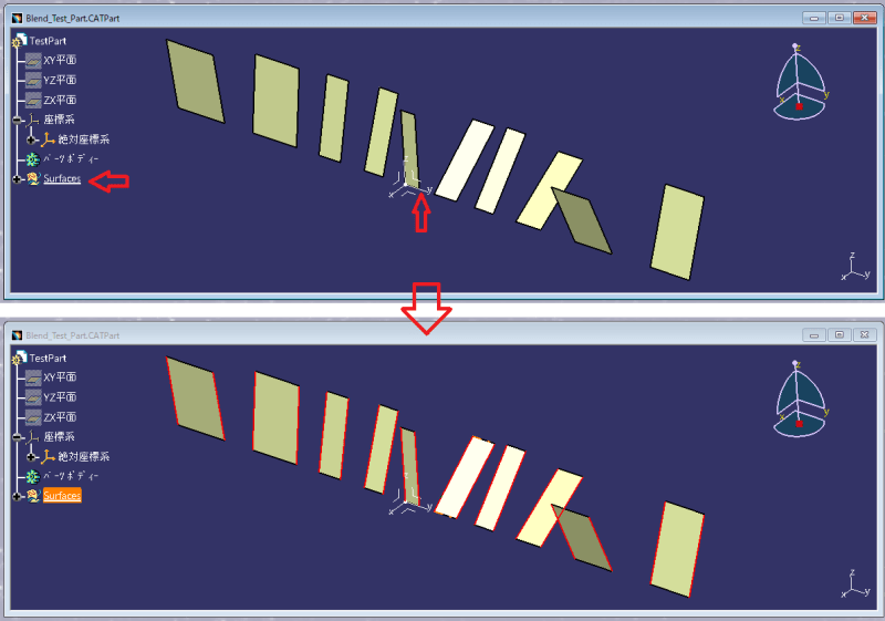

Thanks for the data.
Do I just get the edges that are not always parallel to the Y-axis in sequence?
NaWin55.
Run the following macro, select Yaxis and then GeometricSet.
You should be able to find the edge you are looking for.

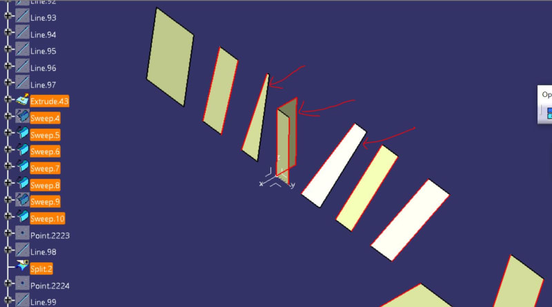

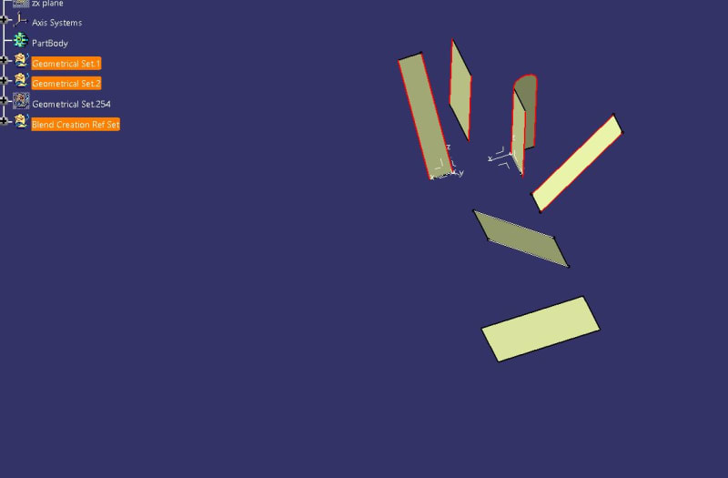

Hi kantoku
sometimes macro will select all the edges
i have selected Y axis and selected surfaces
so this is completely depends on which axis direction user going select
what if we give a msg like "are the selected edges are required edges or not", if not select different axis direction and try again

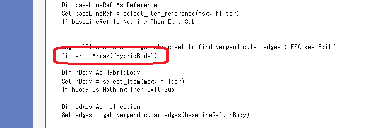

If you select a surface in the second selection, you will get the geometrical set to which the surface belongs.
See the selection filter.
I only made one example of how to get edges that are perpendicular.
That is because your first question was.
