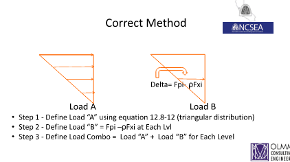

This might be the concept that has been missing from my design ideology for transfer diaphragms and what e95kwon was referencing with this image

My mind assumed that the max ELF xfer forces would not be concurrent with max inertial diaphragm forces.
A reference stating that it's required, or a reference showing how to perform the analysis? It's true that the ELF force distribution doesn't necessarily occur at the same time as the peak diaphragm response at a given level, but there's no way to account for that in an ELF based design. When a transfer diaphragm experiences its max inertial response it also clearly experiences some level of transfer force from the VLFRS above. See the code snip below that requires the two load cases to be considered concurrently. If you felt that was too conservative, you could perform a nonlinear time history analysis (which is obviously way beyond what you would do for a standard building).
