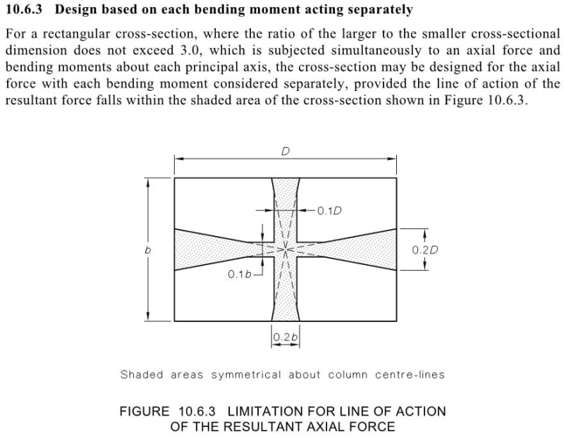

Inherent inaccuracies in the rectangular stress block for non-square section shapes at the 45 degree rotation compared to the square compression faces at 0 and 90 degrees do not help.
The approximate method in 10.6.3 combining Mx and My shows a very large increase in capacity.
