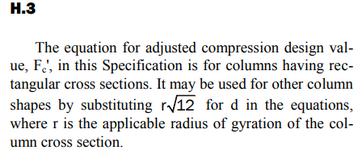

I'm struggling to understand AASHTO's (Stnd Specs) guidance, which I have to follow instead of NDS.
I understand NDS's approach:
The derivation for equation H-2 above is as follows:
Then if you have a circle instead of a square cross-section, d gets replaced with r * sqrt(12), where r = radius of gyration. This I can also derive:

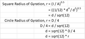

But AASHTO's (Stnd Specs) equation for Fce is different, and I can't understand it:
Basically 0.822 from the NDS formula, which can be derived mathematically, is replaced by the factor KcE, which varies based on type of lumber (and is significantly lower)? And how do I adjust this for a circular cross-section? Do I still just replace d with sqrt(12) * r?
