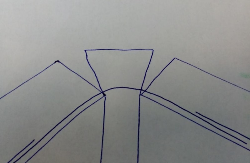

Hello all.
I have a question (actually need a solution) regarding bottom "integrity" steel provision for two way slab design. As per Figure 13.3.8 of ACI 318, at least two bottom bars in each direction must pass within the column core and be anchored at exterior supports.
However, we recently poured a slab and this requirement was not followed by our field personnel. the rebar was placed as per the required spacing (#5@12" O.C), but some of the columns only had ONE bar going through the core instead of two. Unfortunately, the field-inspector did not realize the mistake until the last minute, but it was too late to do anything.
Now, we need to come up with a solution to fix this issue, but we never encountered this problem in any previous projects. Has anyone ever come across this issue?
I will really appreciate your help with this matter.
Additional Information:
- Total Area of the Slab that was poured = 100,000 square feet.
- Thickness of Slab = 20% is 8” and 80% is 12”
- Number of columns = 300
- Typical Columns size: 18”X24”
- See attached sketch for more information.

I suppose you might be able to drill a hole through the column, directly under the slab, and install some sort of supplementary "continuity" rod that could be extended out past the column some distance and bolted/bracketed to the bottom of the slab.
I think the intent of running two bars through the core of the column rebar is to create a pinched-bar condition should a column support fail below....creating a catenary suspension condition with a missing column.
You would have to know the position of the column vertical bars and also possibly allow for drilling in two orthogonal directions if the missing bars occurred in both directions at one column.

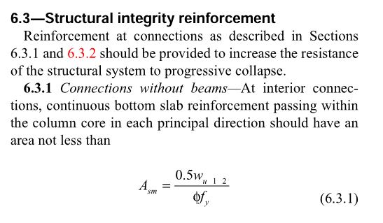

I'm looking at the commentary to the 2014 version of ACI 318. Section 8.7.4.2 (structural integrity).

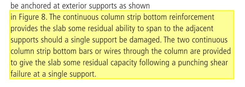

ACI 318-14 said:
The continuous column strip bottom reinf provides the slab some residual ability to span to the adjacent supports should a single support be damaged. The two continuous column strip bottom bars or wires through the column may be termed "integrity reinf" and are provided to give the slab some residual strength following a single punching shear failure at a single support. ACI 352.1R provides further guidance on the design of integrity reinforcement in slab-column connections.
It doesn't seem like punching shear strength itself is the focus here. Rather making sure that the slab has residual flexural strength post punching shear failure.
I would recommend taking a closer look at that ACI report 352.1R, it may give some guidance on alternate ways of providing integrity. Off hand, I don't immediately see how missing the column joint slightly really changes the integrity aspect very much. But, I haven't ever focused on that aspect of the code before.

To restate my opinion as clearly as possible, I believe that the intent of ACI 318-14 section 8.7.4.2 is twofold:
1) Continuous bottom bars are provided through the column cage so as to provide a secondary mechanism of resisting punching shear should conventional means fail AND;
2) Continuous bottom bars are provided throughout the column strips to provide for some caternary resistance should #1 fail and column support be lost altogether.
Put my level of confidence in my interpretation around 95%. Punching shear resistance is very much the focus of the integrity steel provisions dealing with continuous bottom bars passing through column cages.
As evidence of this, I submit the following:
1) See the attached PCA document dealing with integrity steel. In particular, not the paragraph clipped from that document and shown below. Sadly, like the source provision, the exact wording hasn't quite been articulated in a way that precludes all possible avenues of misinterpretation. That said, I still very much read that as supporting my view.
2) If the two bars going through the column were all about the caternary action, why would it matter that they pass through the column cage? The column no longer exists as a slab support when that caternary action would be engaged.
3) When ACI 352.1-11 discusses slab to column integrity recommendations, both the form of the equation and the supporting sketch suggest that the force being dealt with at the connection post-post failure is the gravity load being delivered to the column by the slab via punching shear. Nothing about this information suggests that caternary action is being considered in the calculation.

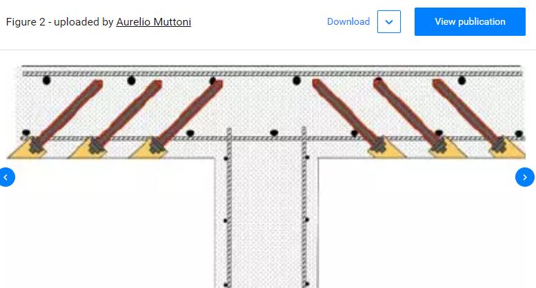

@ma3355: any chance you have stud rails at your columns? If so, it may be feasible to count the bars placed over the rails as substitutes for the bars placed through the column cages. ACI 352.1-11 suggests a similar approach where shear heads are used. Of course, shear heads aren't often used but I would consider stud rails to be substantially similar in concept for this purpose. Obviously, this would be a great "do nothing" fix if you've got those stud rails.
There may be a way to make a go of this even without stud rails. Hilti has a drilled in punching shear reinforcement solution that could get you back to a ductile shear resistance system similar to the stud rails and/or shear heads. Still not cheap but at least possible as a means of being able to count slab bottom bars outside of the column cage.
