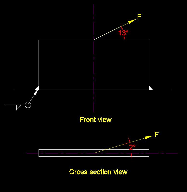

Hello everyone,
I am checking stresses on a rectangular plate (SA-516-70) results from an external load. below is a summary of what I have:
1) Maximum strong axis bending stress is fbx = 15,964 psi, allowable strong axis bending stress= Fbx =0.6 x Fy = 22,800 psi.
2) maximum weak axis bending stress is fby = 5,745 psi, allowable weak axis bending stress = Fby = 0.75 x Fy = 28,500 psi ( the section is compact per AISC 9th edition).
3) Tensile stress = fa= 740 psi (allowable tension = Ft = 0.6 x Fy = 22,800)
now can I say the design is acceptable because:
1) fbx < Fbx
2) fby < Fby
3) fa < Ft
4) fa/ Ft + fbx/Fbx + fby/Fby= 0.93 ≤ 1.0
or I have to find the combined bending stress to check that too separately. if yes, what will be the combined stress and its allowable, will it be √(fbx2 + fby2)= 16,966 or just by adding up fbx + fby = 21,709

yes the three stresses are imposed at the same time but there is only one load applied on the plate. (load has lateral angle so produces weak axis bending too)
I am checking stresses per AISC 9th edition chapter H, combined stresses, (H2. AXIAL TENSION AND BENDING) and equation H2-1 which is fa/Ft + fbx/Fbx + fby/Fby ≤ 1.0

Thanks everyone for sharing your thoughts, below is a snapshot of what I have. the shear stress is very small almost 20% of its allowable (I know if the shear stress is less than 60% of shear allowable stress then it can be ignored). so basically I have strong axis bending moment, weak axis bending moment and tension on a cross section at the very bottom of the plate.
@ winelandv, Regarding allowable bending stress at strong axis, per AISC should be (0.6 to 0.75) x Fy, so I am using the minimum allowable. am I not correct?
I am a pressure vessel engineer (mechanical engineer) and not expert in AISC standards. this is a part of lifting lug design

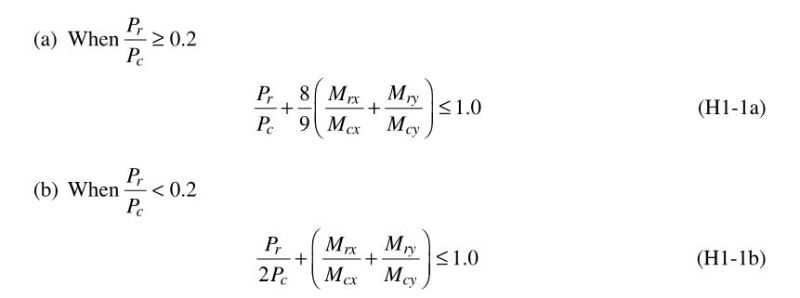

OK - so based on your posted graphic this is not necessarily a von Mises but you might do as you suggest:
fa/ Ft + fbx/Fbx + fby/Fby ≤ 1.0
However, AISC currently has a different interaction equation:
The whole AISC spec can be found (free) here: Look in Chapter H in section H1.

At any rate, for the combined stress check, JAE has set you on the right path (though AISC has changed to a strength basis instead of stress for all their design equations).

@ JAE, I am aware that current AISC has different equations I rather to use the old equation since it looks much simpler to me than new equations. I think I should be fine using the old one as new AISC states "User Note: Section H2 is permitted to be used in lieu of the provisions of this section." which H2-1 has exact same old equation. the only thing I don't fully understand is why are we're adding strong bending stress and weak axis bending stress when in fact they are not in same directions. (they are perpendicular)
@ winelandv, Thanks for your input, I am aware of other design requirements of shear, bearing stresses at pin hole and the rest and I am checking them too.
the bending moments are in different directions but the stresses on the section are the same (tension/compression).
