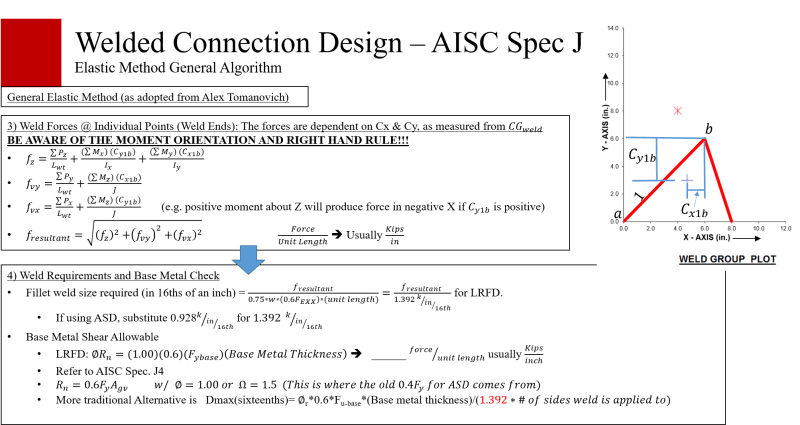

I find the the way to combine those shear stresses. At first, divide all stresses vector along x, y, z axis, then combime it as sqrt (tx2+ty2+tz2).

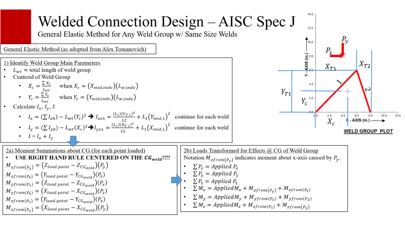

Back in the olden days (2017) I made this "for dummies" explanation of the general elastic method for 2D weld groups, while studying for the PE exam. It's kicking around in a few places online. I didn't derive anything, just made the flow more suited to visual learners like myself.

DrZoidberWoop:
nice document there very informative. only minor caviate I would add is the under fz you note M c / I for the bending components of the stress this formula is really only correct for principal axis bending. For the shape you show in your document moments about the X and Y axis would be non-principal axis moments so you should really be using the general bending stress formulas, although folks have used My/I for years per Blodgett and not gotten into trouble, likely due to the highly conservative nature of the elastic method.
Celt... I noticed that in your spreadsheet and had missed it in my initial attempt... thanks...
Celt83: That would be a really good update to the Tomanovich spreadsheet, and all the knockoffs I've come across. One of these days, I'll have to make the update.
