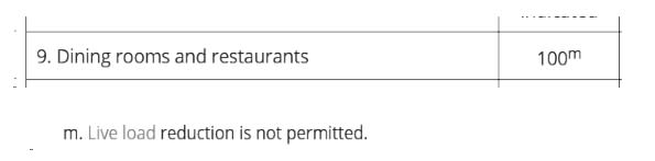

I am designing a deck for a restaurant and the code requires a 100 psf live load. The deck will be 12" above grade. Can I reduce the live load based on 1607.11.1 Basic Uniform Live Load Reduction in the ibc and use the reduced load to design the floor joists and support beams?
The deck is 24'x50' If I can reduce the live load would the At value be 24'x50'= 1,200 sf and the KLL = 2?

Make sure you're even allowed to use live load reduction. Dining has footnote "m" after the 100 psf, which says you can only reduce if you meet the exceptions, and from your description it doesn't seem like you do. This might differ depending on which version of IBC you're using, since you didn't specify.
You need to use the tributary area of the supporting members like jayrod said, not the entire area of the deck.

I agree with kipfoot and straub46 - this would essentially be an assembly area. Furniture + customers + wait staff stomping around and singing happy birthday (someday, I hope) makes the 100psf plausible.
It all depends on whether you determine it to be an area of public assembly or merely a deck / balcony. That's a matter of engineering judgment. But, the fact that it's only 12" above grade makes me MUCH more comfortable with the idea of calling it a deck and allowing it to be reducible. Maybe not if it were a school or hospital. But, for a regular old restaurant.... I'd personally call it reducible.
Just remember that the KLL is multiplied by the tributary area, not the total area.
